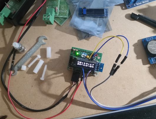

I was using the SSD1306 I2C driver
and a few times I needed to start fresh
and when I did
library delete
a few times I got
CPU exception #10
In CFunction at address 0x9D00DF74
Processor restarted
or this
CPU exception #10
In CFunction at address 0x9D00E02C
Processor restarted
this is a well used chip so I tried
a few new ones same thing.
no problems using the driver.
just letting you know about it.

  Quote  a few times I got
CPU exception
This is a benign artifact of the way the driver works. When you output to the SSD1306 the program just updates a memory buffer. There is then a timer interrupt that runs that checks for any updates and does the actual change to the display.
When you delete the library depending on the timing the timer interrupt could fire but the code has gone so you can get a range of errors at this point but a restart clears it all up.

I am using the Mite to do 4-20mA to pulse and this
very tiny display is just right to show the 4-20mA
input and the divider and current pulse rate.
Any way around the reserved pin as I was going to use
I2C for RTC?
I set the RTC up in MM.startup before starting the driver
but cant make any other use of it to adjust the Mite time.
Aw as I typed it hit me use the output to interrupt me
once and hour and that should keep it in time. Or use
the 1Hz and keep a count for the hour.
Thanks for your work on all things MicroMite

  Quote  Any way around the reserved pin as I was going to use
I2C for RTC?
The ssd1306 driver can use any pins for SDA and SCK. They don't need to be the normal I2C pins. It uses a bit-banged I2C driver and not the PIC H/W
