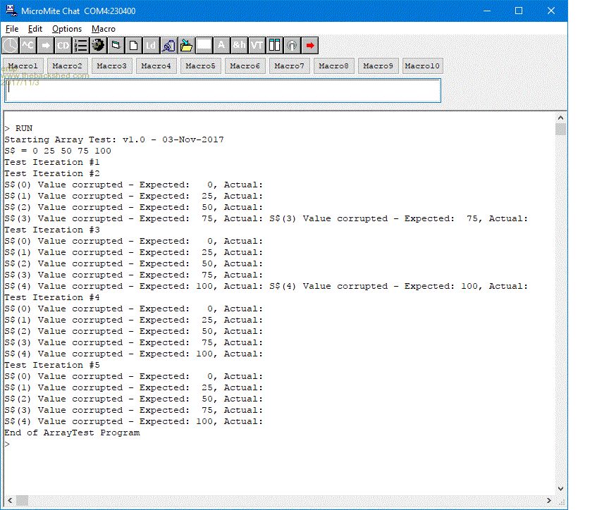

I recently experienced corruption of data stored in arrays within a program I was working on. I have isolated it to calling a procedure and passing an array as the argument. I know the procedure arguments are passed by reference so any change made within the procedure will reflect in the data after returning from the procedure call. But in this case I can see the data being corrupted even when the procedure contains no code whatsoever.
Sub PassArray(TestArray() as String)
'do nothing
End Sub
So calling PassArray passing a string array as the argument results in the data in the array being corrupted after several call iterations. The first call is OK.
The screen shot below is from the ArrayTest program I have written to test/isolate this. It declares a 5 element string array (S$) and calls the PassArray procedure 5 times passing S$() each time and checks the contents of the array elements after each call.
Test iteration #1 reports no data corruption, iteration #2 reports corruption for the first 4 (of 5) of the array elements, and subsequent iterations report corruption for all 5 elements.
If there are multiple arrays declared (as there was in my original program), then all arrays seem to be affected even though only 1 has been used to pass in a procedure call. This happens even with a mix of String and Integer arrays and makes the results very confusing.
This is running on an E28 module with firmware 5.04.05, but I have also tested and found similar results on a Silicon Chip MX170 LCD Backpack Mk2.
The full listing of the test program source is below.

twofingers
Joined: 02/06/2014
Posts: 1772
Posted: 02:30am 03 Nov 2017
Yes, I think it is.
Maybe you can try a MMBasic V5.0.
This bug is already reported.
Michael

Posts: 3368
Posted: 03:52pm 03 Nov 2017
Yes, it is a known bug (the current DOS version of MMBasic already has this one fixed).
I have a small collection of bugs/issues to be sorted and I'm planning a new release in early December to fix them.

Posted: 04:25pm 18 Dec 2017
Hi Geoff,
this bug is still alive! MX170-28/MM V5.04.06
Best regards
The lone and ...
twofingers
Joined: 02/06/2014
Posts: 1772
Posted: 12:17pm 23 Dec 2017
This bug is eliminated with MX 170-28/MM V5.04.07
Thanks Geoff! Edited by twofingers 2017-12-24
