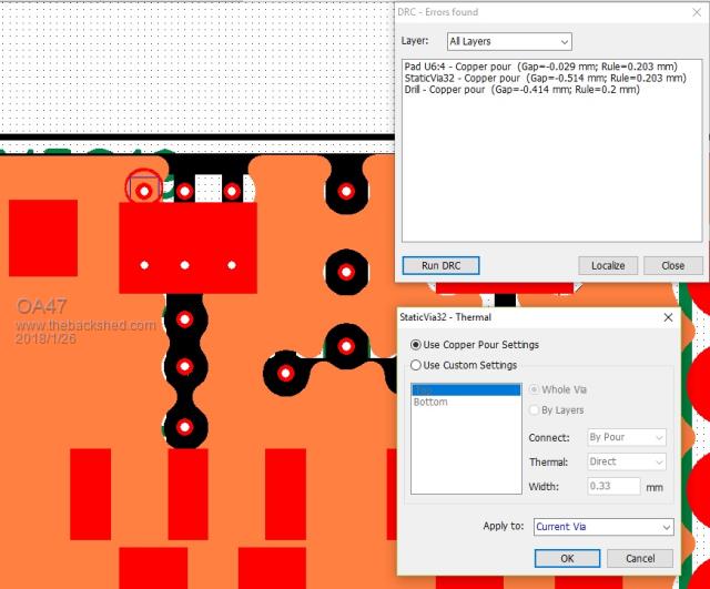

I have a double sided PCB in Diptrace and I am trying to link the ground pads of the 3T regs to the copper fill on the bottom of the PCB with vias for thermal purposes. Every time I try to achieve this I get errors in the DRC. Can anyone help with the right procedure to accomplish this?

I use Diptrace quite a lot, cannot say I have seen this issue; are the Gnd pads on the same net as the copper fill other side of pcb?

Thanks for the Reply Mike. The copper pour was not connected to a net. I didn't have a selection of a ground net but the pads for the ground on the 3T regs was net 0 so I attached the pour to net 0 and all is happy.

On further inspection this looses my bottom tracks so back to the drawing board.
