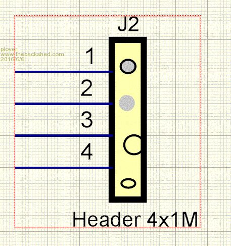

Posted: 04:28pm 05 Jun 2016
Referring to the male/female descriptor for headers, in the tips an tricks thread
Almost figured out how to add the header male/female indication. My main problem getting the "circle/disk" placed on the grid centre.
I have been unable to find the 'centre' as grab point when trying to move an object, in this case the circular object.
I have left an elliptic formed object so I can ask how do I snap to cirle, ie is there a way to ensure it is a circle I am placing.
Believe I noticed very fine incremental changes in the x and y axis when making a circle?
If running a very fine step in snap to grid, is it possible to bring the grid to the front so that one can place object 'spot on' first time?

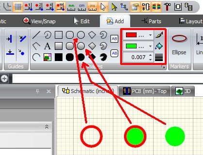

Posted: 02:23am 06 Jun 2016
  bigmik said   Hi Plover,
Hold Ctrl down and the elipse snaps to a circle.
Once your circle is drawn just drag it to the location you want, experiment with the snap grid settings on the top (middle) tool bar.
Also if you want you can change the colour of the outline and the inner fill by clicking on the boxes just to the right of the shapes menu.. currently it is set for BLACK outline and GREY fill.
Of course if you load a part and edit it to put what ever marker you chose you can then save that part away and it will bring in your markings with it.
Kind Regards,
Mick[/quote]

Posts: 2984
Posted: 02:31am 06 Jun 2016
Hi Plover,
This picture might help,
It shows the effect of the 3 different type ellipses,
Note that I have set the BORDER to RED and the FILL to GREEN to show the impact on each type of ellipse.
Kind Regards,
MickEdited by bigmik 2016-06-07

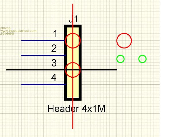

Posted: 03:20am 06 Jun 2016
I have found tha SHIFT when sizing is what I am after, circle get centred around the line start point. I had to experiment with snap setting I think it was 5 points per grid. using the default grid, but I have got the idea. I can now mange to get the circle exactly where I want it.
Yep I also understand at least changing line colours, and I think the fill colour below. That is from your nice instructions.
I have placed a vertical red line and horizontal black line on top of the header just to get the 'proper' center point, as a helper for the time.
The circles to the right just experiments where I noticed I had coarse steps and fiddle around.
