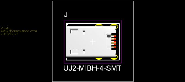

I have been trying to create a 3D part myself, and have chosen the Model: UJ2-MIBH-4-SMT micro USB connector from CUI... This connector is made to protrude 3mm from the edge of the PCB and would be useful to get the connector shell to go through the wall of the enclosure (or box) holding the PCB... It is different from the many types of connectors that are flush to the PCB edge... So, I thought it might be a useful part to add to the collection..
I have the part pads and mounting holes created as well as the schematic symbol and now need to add the 3D model... What model "file format" is needed..? I watched the video on the DEX site as Iylia seems to be pointing to "XGL" type files... The CUI website allows you to download many different types of models, but I don't know what type of program generates the "XGL" file type...
Here is the CUI Model I am trying to download...
Could you have a peek and let me know if any of these selections would produce the needed model file type..?
Thanks Mick for your help on this.. (I am such a newbie)
Hopefully one of the selections would work..!!
EDIT: - I did manage to down the STL type model which did import to the part design... I was not able to move the part along the "Z" axis to get it to the correct height.. STL files seem to lack any "color" information... Yikes... Getting late here... Will fuss with it more tomorrow after work... Edited by Zonker 2016-12-21

Hi Zonker,
That link didn't work .. At least on my iPad ... But I found the part on trace parts..
Off the top of my head I used to download the SOLIDWORKS 3D then load it into autodesk INVENTOR to save out as an XGL part and load this into DEX ... Then Iliya implemented VRML / WRL import which works but there is always a magnification factor that needs to be set when you import the 3D into Dex ...
Trial and error gets this right and it seems it varies from part to part, the sample I did for the TO220 took me 6 or 7 size adjustments to get it right.. Still no real problem at about 10sec per attempt..
Once the part is loaded you can select it in 3D view and rotate and move it until you are happy with the alignment to your pads..

I followed your second suggestion first and tried playing with the 3D file type "WRL" and noticed the scale setting issue also... Seems weird to me that the 3D model wouldn't be rendered exactly 1:1.. But, whatever... While playing with scaling, (ended up at 10), I noticed I was not able to move the 3D model up and down along the Z axis... Not sure why this was... Next day, following your first suggestion, I took the Soildworks 3D model to work and had our Inventor guy (Stephen Teppen) convert this into a "XGL" output object file and tried again tonight... Well, it seems everything seems to have turned out OK..
You can take a peek at it when you get back home..!
2016-12-21_041538_UJ2-MIBH-4-SMT.zip

Hi Zonker,
That looks a nice part to add to our collection of USB connectors (I have a MINI USB THP and SMD)
Now you stated you wanted a good `THROUGH HOLE' but that one you have designed is a SMD type? Did you just mean Through Hole for the mounting?
If you think there is a possibility of the connector being torn off you can also add two solder pads (one on each side of connector and then a wire can be wrapped over the connector and soldered down (via the pads) to provide some extra strength.

Hey Mick..!
I hope you had a chance to peek at it... Yep, I was concerned about having good support and wanted through hole main supports for the main body of the connector.. It's ok if the pins are SMT...

I have finally had a look at the part.
Looks great. I think I might start using that one as MINI USB is likely to be superseded by Micro USB.
I have to admit I didnt really like the solder tab sizes/shapes for the mounting legs.. They had no `meat' on them and would tear away with little effort IMHO so I changed the pad size to 2.5mm x 1.5mm ..
I also changed the shape from an oval to a rounded rectangle (done in properties when the pad is selected)
I have attached a ZIP with my two MINI USBs and my modified version of yours..
