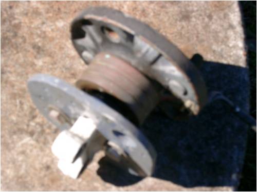

Hello,, Sodes,, This is the Cortina hub that I fitted the copper rings to --sort of 6mm "wedding" rings from copper water pipe with the cable soldered inside..
The brush holder is somewhere in my store ,,but too many black snakes in there at present to find it.
Actually the brush holders were just automotive generator or alternator holders,,retrofitted to alumimium angle ,,two brushes per ring --worked very well,,but the resistance is the killer,,at 12volts.
