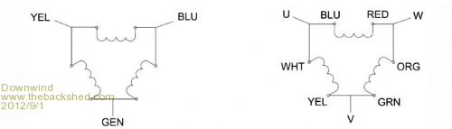

At the moment I'm more interested in the other motor in there, though. Assuming you had a Laserjet you might have found the same. After A LOT of searching, it turns out the main drive motor is a Nidec RH7-1171, 24v, 1.1 ohm. There's very little about the spec online, and I don't know much about them, but from what I can tell it's a 3-phase hybrid stepper motor. It's a really nice design, which lends itself to turning it into a VAWT with very little trouble. You could literally just stick a set of arms/fins to the top. The question is, how best to wire it for maximum output?
I can't open it up (three screws in the top just refuse to budge) but to me it looks like there are four inputs: three coils, which are all joined at one end. I've used an LED against the four inputs in all combinations, and it works in all (which supports that theory - in each case there's at least some coil between them). Like this: http://www.osm-steppermotor.co.uk/img/3-phase-nema-17-steppe r-motor-wiring.jpg
So, how to use that to best effect...?

There looks to be 2 types of wiring types for the motor you have, do your motor have 3 wires or more (how many wires)
The basic wiring for a generator will require 6 diodes to make a 3 phase rectifier.
Honestly i feel you will be fighting a loosing battle with that motor for a generator, due to the fact of its strong cogging effect, and is likely to not spin until there is a cyclone approaching.
Over all the power output might charge a couple of Nicad cells but will be next to useless.
That said and understood its still worth making a wind generator from it just to learn how hard it is to extract energy from the wind and make power with it, dont expect to disconnect from the grid anytime soon.

One thing to be aware of.
It is normal practice to always connect three phase alternator windings in star connection.
The reason for this is that if the voltages generated are not three perfect sine waves, connecting the three windings in closed delta will result in circulating currents around the three windings. That could well waste power and heat up the windings all for no useful purpose.
You can test this for yourself by breaking into the closed delta connection at one point, and measuring the circulating current (if any) with a low impedance amp meter.
It may not matter, or it could be a significant problem, depending on what you have.

Pretty sure that what I've got/want is one of these:
Downwind: are you talking about the Mitsumi or the Nidec? Because whilst the Mitsumi seems pretty tough to turn, the Nidec seems like it's made for the job. Nevertheless I'm interested to hear how others have got on with the Mitsumi since I've got one kicking around.
