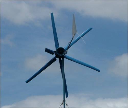

Well it was an interesting weekend for the windmill.
I arrived home Friday to see the tower shaking itself to pieces and making all sorts of horrid noises. The 6 blade turbine had thrown a blade, and the out of balance was shaking the "bleep" out of the tower. I shorted it out to bring it under control, and tightened the guy wires, everything was loose. The broken off piece of blade was near by, clean break through most of it, where a bolt goes through. No sign of impact, I think it just "broke off". These blades are 2 years old now and starting to fatigue, so time to replace them.

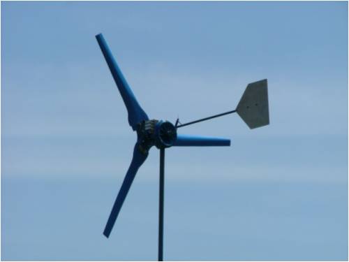

I dont have the time to make a new set, so dug up my old timber blades and 7 phase stator as a quick replacement for the PVC blade dual stator windmill. The blades were made by Dennis and are good performers, though a smaller diameter than the PVC blades. They are a good match for the 7 phase stator. By Saturday afternoon I had replaced the broken mill with the new one, just in time to see a few amps before the wind died off for the day.
