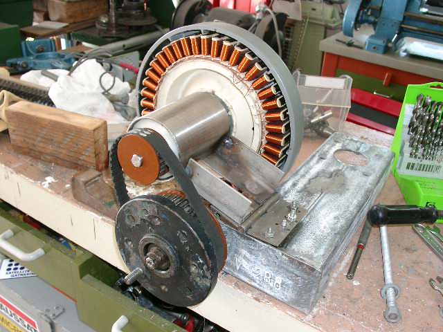

This is a sneak preview of my new ,(hope it works) , timing belt drive. I used a 2:1 gearing and it seems very easy to turn ,hardly any friction at all. ,so I hope when the magnetic rotor goes on it will still be easy to turn. I'm fitting 11 foot "oregon pine" blades to this hub(ford cortina).
wish me luck.
Bruce

Hi Bruce
 Well done I will buy shares in the  Mt Tamborine power company too About  belt and sprockets look the same as l have as came off holden camira engine or Daewoo,holden Barina as  in all same family motor and also can buy sprockets from Bearing and Seal  dealer however not cheap but Belt can be brought in driffren lenghts over the counter Finley l got my new lathe going over the weekend after months working on 10kva 3hp altenartor couple to Corolla motor so l able to start making windmill gen with f & P in next fews weeks  l will try visit you soon and will let you know Clap

I got the belt and sprocket,small one from an engineering Co in Sydney a couple of years ago,one of those hard to find second hand joints.  But car wreckers places will get the same stuff-the belts being much larger,so you'll have to buy a shorter one from "blackwoods" or "bearing services" Etc.-around 30 dollars.
I'll get stuck into finishing off the blades now that I have the "test" pole up for balancing,Etc. Hoping to get good results from 3 years of finishing off these bloody monsters-takes me ages to get things finished,with a big property ,I have hundreds of things to do .

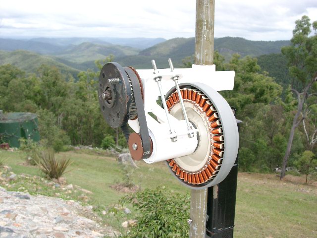

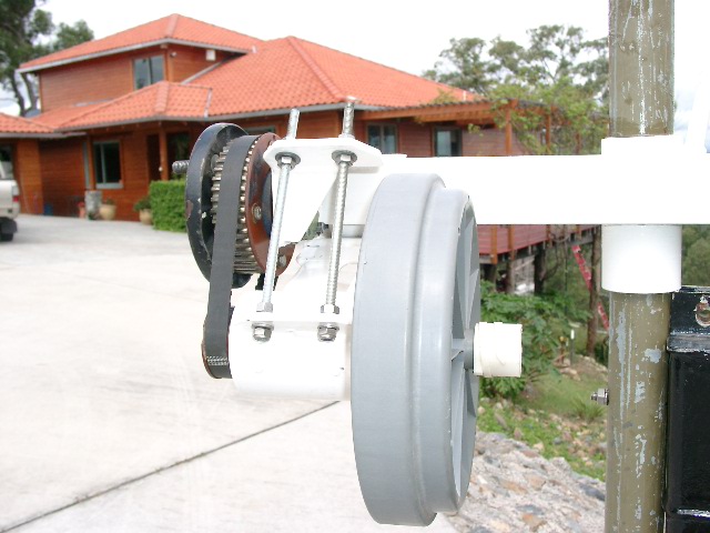

Yes, I still think that was a good idea and it worked well til it must have become a little loose and in a storm it must have been producing so much power it jumped a few cogs in one of the gears and from there on stripped the rubber and fibre webbing from the belt ...
Just looked up my diary from 22-7-08. 845 watts in to a 48v battery bank with 100 S stator and a retrofitted Neo magnet rotor. They were the ABS pipe blades that Phill and I made back then ,,since broken in a huge storm .

I must say I always liked this puppy too and Bruce never took it to the nth degree, dual stator, low voltage, cap doublers. reduction drive = high speed thinking with the right amount of persistance could have got almost 2KW out of such a config.
