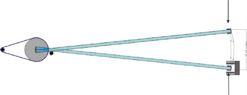

i have a small idea in my small brain that i can not shake off, it involves converting a vertical rotating motion to linear up and down motion
i know it is possible but how? and it has to be mechanical only no funny gadjets only things that i can find easly.
any ideas??
thanks

i am trying to use the levrage that a pry bar produces.
we all know the longer the bar the easier to pry somthing because it takes less energy due to the legnth of the bar and levrage.
i dont know the proper term for this sience but i am trying to use it in my vawt, If it is possiblea and that is my aim.
thanks

[quote=faroun]
we all know the longer the bar the easier to pry somthing because it takes less energy due to the legnth of the bar and levrage[/quote]
Sorry, but no.
Less force X more distance = Same Energy
Brush up on that science before designing things. To many of us the learning process, no matter what background we have, makes the whole project worthwhile. But ignoring basic physics can make a project downright frustrating.

ok, but can you please explain a bit more.
i dont understand the "Less force X more distance = Same Energy"
i am willing to learn and accept.

There seems to be some confusion here with force, energy, and power.

here is a quick rendering to show to objective.
