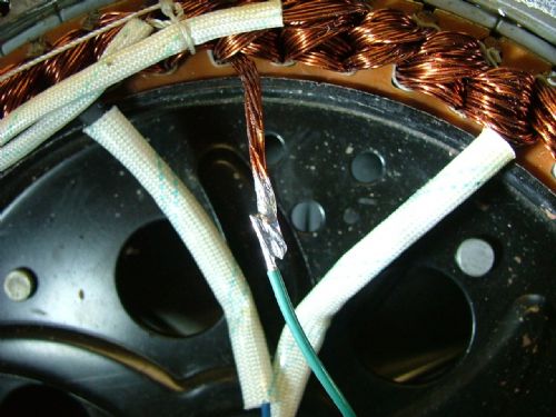

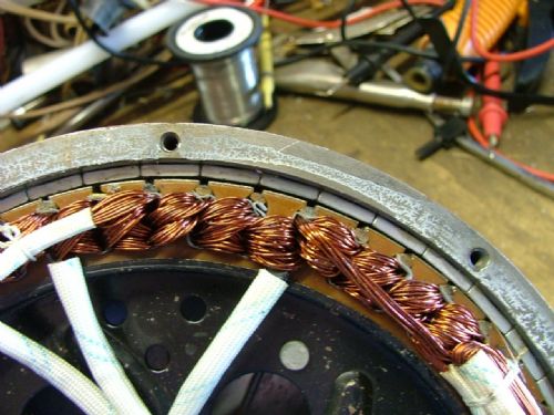

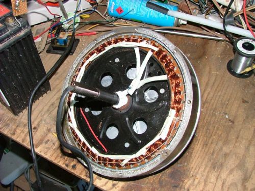

Just for interests sake.
I have a 300 watt hub motor from China. These are very well made, though there are a couple of area's that need attention before they could be used on a windmill.
The first concern is the shaft. Its 15mm at its widest point, with a 7mm hole down the middle for the wires to pass through. On a push bike where the motor is supported at both ends of the shaft, this would be sufficient. But for a windmill where its only held at one end, it would break easily of the turbine was out of balance or there was a sudden wind direction change. It would be easy enough to strengthen, with a new shaft or a sleeve and bigger bearing.
The other problem I've noticed is the lead out wires. The coils are wound multi strand, 8 of 0.6mm copper enameled wire strands bundled together to give a diameter of about 2.5mm, but the lead out wires measure only 1.2mm diameter copper, thats a big step down in cross section, and a big reduction in the current handling capability of this thing either as a motor or alternator. The easy fix is to mount the rectifiers inside the alternator, connect the -ve to the shaft and feed a single 4 or 5mm copper wire through the 7mm hole as the +ve.
There is no noticeable cogging, and its easy to turn my hand. Here's a few photos.

Yeah, hubs are a good thing if you can get your hands on one. I figure they were generally too small, but yours is of a decent size and looks like it has neos for mags?

out of interest, How many magnets and slots?
Gordon.
become more energy aware
Posted: 10:02am 17 Mar 2009
Hi Gordon
46 magnets, 52 stator poles, and the stator is about 200mm diameter. Spin by hand gives approx 10 to 15 volts at approx 100rpm.
