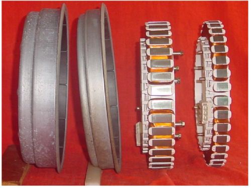

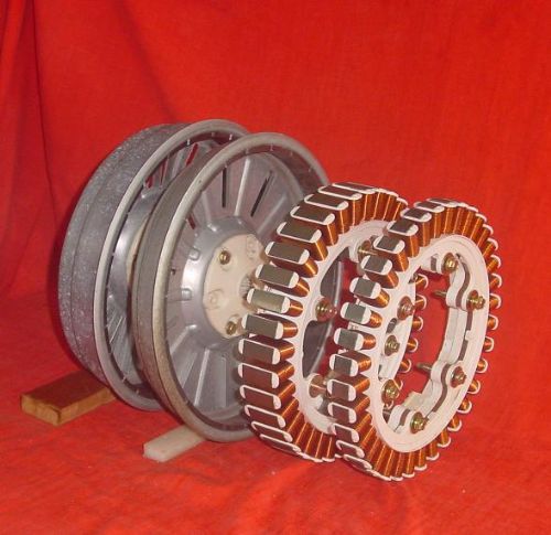

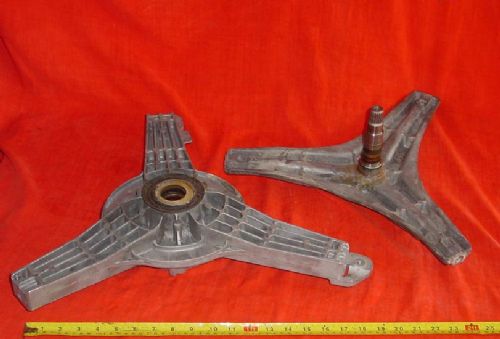

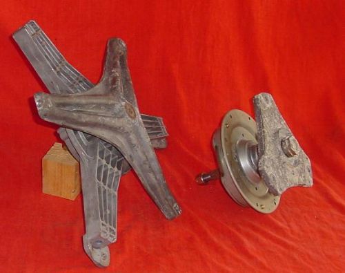

Hello to everyone

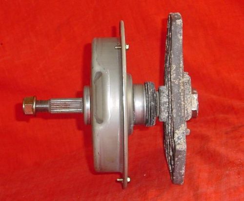

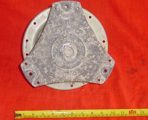

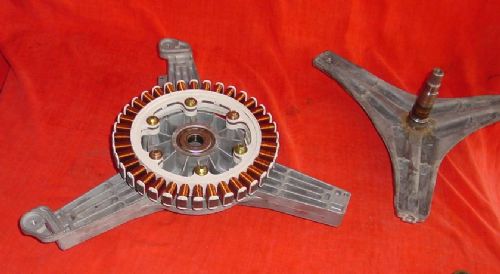

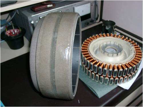

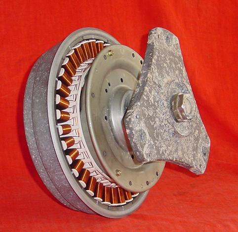

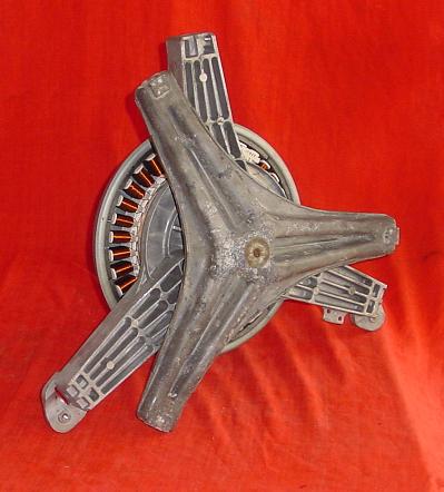

I came across another LG smartdrive from a frontloader.
Quite different from a top loader, smaller motor, same diameter, and totally different bearing holder. I think the frontloader has a 500 watt motor and the the top loader a 1500 watt???
Both have oversized bearings compared to F&P, and there would be very little to machine for windmills, both drumholder could be used as they are to mount blades on them, they are very strong.
When I have time I will test them on a lathe for power output, If anybody wants to assist I live on the sunshine coast.
If anybody has already some date info, this would be very appreciated, maybe there are some configurations which could be skipped??:
2 (different motors) x 2(star or delta) x 5(12s,6s,4s,3s,2s,) x 3 (12/24/48/volt)=60 variations x caps..... endless??
but we all together should be able to get some results. this is one of the best website on earth!!!!
BTW: no cogging and the bigger one should have more power than F&P, we will see.
Harald
here are some pics:
Toploder with original flat mounting plate
Toploader complete
left frontloader right toploader
Frontloader, left statorholder, right rotating drumholder, perfect for a horizontal wind machine
frontloader
frontloader

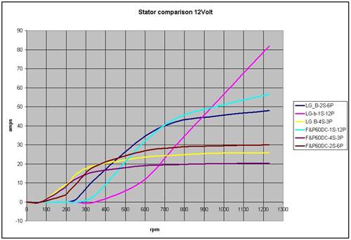

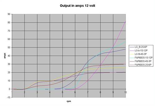

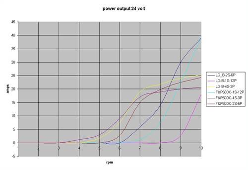

Posted: 01:44pm 08 Jun 2009
Hi

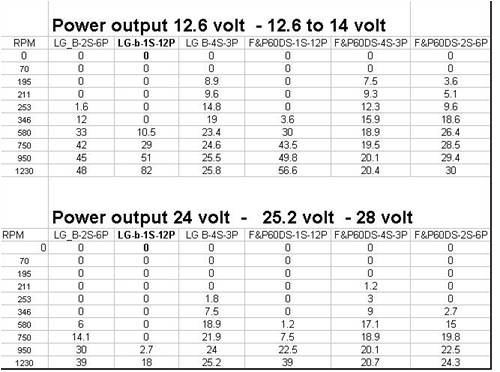

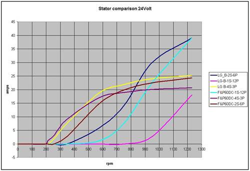

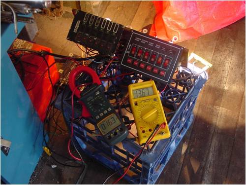

I finally got around and did some test last week.
output data is for the wider LG and the 36 pole, non cogging F&P 60DC 0.6mm wire(named it accidently DS)
The one piece shaft assembly from the smaller LG (see pic.) bracket didn't fit in the lathe and I didn't want to cut the shaft off, it's to perfect for a blade holder.
I measured only one phase and tripled the output
So all measurements are for delta wiring!
I need from somebody a hint, or where to get or how to use an exel chart template to accomdate the unregular rpms of the lathe. The rpms are not regular spaced on my lathe thats why the chart is misleading easy, as well the curves are not proper displayed.

Hi harald,
You need to do a scatter plot, not a line plot.
Use the rpm in the first column, and the other data in successive columns.
Deleted graphs to avoid confusion. Glad U were able to post bettter graphs below.
The LG has similar issues to a F&P, but this would be expected.
Gordon.

Posted: 02:33am 09 Jun 2009
Thanks Gordon, looks much better.
I expected more power at lower rpm from the LG compared with the F&P.
cheers
Harald

Posted: 03:52am 09 Jun 2009
Here are the corrected charts, thank's to Gordon.
BTW: retcifier was via schottky diodes
Harald
