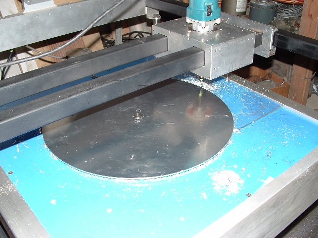

This is my wxyz machine

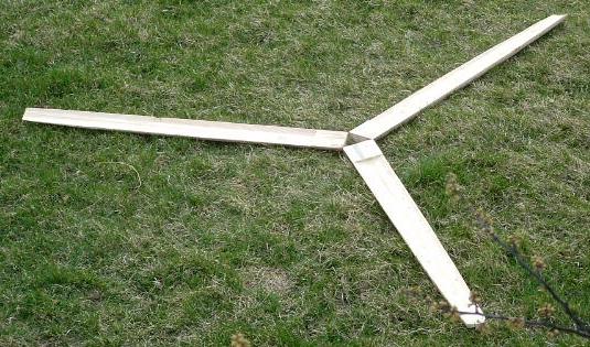

I am also working on a new set of windmill blades. Laminated strips of fir together and now I am cutting and sanding. Just plain having fun. Joe.

Greetings Joe (say hello to the pump worm for me)
Have not had such a good giggle in years.
It seems you are a man of many talents, And the WXYZ machine fascinates me.
More input required about this box of tricks otherwise I will be forced to launch my patented worm deflating missile from an under ground bunker some where in South Australia.
Looking forward to your reply.

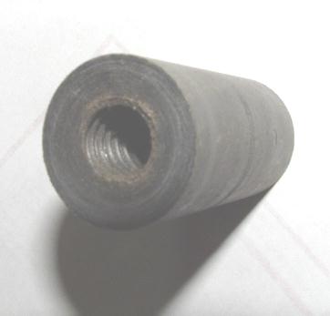

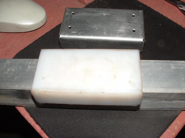

This is a machine slide that I have developed over the last few years. It is made of 38mm poly chain guide.
The nylon thread bushings are 52mm in length 25mm in diameter and taped with square acme thread 10 per inch.
After several years of steady operation in all kinds of machines. I have found nothing that will out last this design. The stuff wears like a pigs nose. Joe.

Hey Joe.
How do you find the poly goes with drag or slop? I'm considering building a new router, and looking at alternatives to the roller bearings I used as rail runners.
