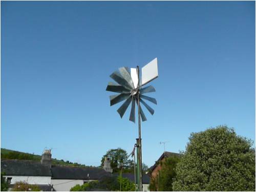

Hi I am new to this forum and wind pumps. I have built a high torque windpump to circulate the water in my fish pond it has twelve blades and is one meter diam. As it has a crank driving the pump rods, to balance it do I just balance the turbine on its own or with the pump rods connected.

Philp, Here is a photo of my wind pump. The main shaft is connected to the turbine which in turn has a crank on the other end. The crank is connected to aluminum pump rods which operate the pump. In the photo it is only fixed the the washing line post for testing.
There is a book on it called "How to Build a Wind Pump" by Jim Barr

Nice looking job there Bob.
It is the fan that needs the balancing firstly. The crank needs to be off the fan for static balancing this part.
Can't see how your crank is built, but my first guess is that if it is light, or a pin in a disk style of thing, it won't add too much to vibration. If it is substantial, then counter balancing the crank ideally needs to be in the same plane (if at all).
Get the fan right at least.
Nice to see a home brew wind pumper.... mine is a commercial one (50years+ old)..... and I still love it.
Whist this is a long distance opinion, I believe it is critical to get the high mass blades well balanced in their own right.... the rest is less mission critical.
Mine is only 5' or so, but a small fan imbalance leads to frightening wobble.... never mind the bearing sleeve wear....
