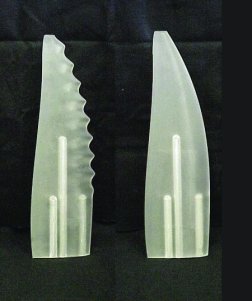

Here is a link to an interesting .pdf file on fluid dynamics.
http://www.appliedfluids.com/UUST01.pdf
It outlines the use of wavy bumps (tubercules) in the leading edge of an airfoil shape to both decrease drag and increase lift of the airfoil in a fluid.
I am guessing but since air is a fluid - the same principles might well apply. The difficulty in making a set of test blades would lie in actually cutting a number of blades with identical bumps along the leading edge.
(hint: It would take a CNC router to do it accurately)

It's not so much small dimples that matter in this case - but larger bumps or just a scalloping of the leading edge.
I think that if it gives 5% to 10% better performance - on a big blade that is a substantial difference in output over time.
here's some more on the same subject:
http://www.sciencedaily.com/releases/2004/05/040512044455.ht m
http://www.dukenews.duke.edu/2004/05/design_0504.html
