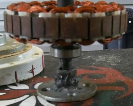

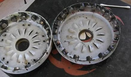

While my F&P Windmill is waiting on town permits, I decided to see if I could modify a ceiling fan motor using odds and ends lying around the house..
So I begun hunting the house for things I can use and I decided on dremmeling the bottom out of an old metal dog water bowl. I hacked a hole in the bottom for the fan bearing/shaft to come through the dog bowl fit over the armature with a little room to spare. I was able to squeeze round neos between the dog bowl and the outter metal housing.
The motor has 16 poles, so I used 32 neos.. I aligned each pole with a row of two neos. I brushed on some extra epoxy I had sitting around and filled up the gaps with clear RTV silicone to make a rubber-like form in all the spaces.
The upper magnet sticks out almost 1/2 way to the armature center point, but the magnetism is definitely skewed more towards the front end. When running a test magnet inside to feel the strength and verify polarity, the field through the dog bowl is very strong. It pushes my hand to the middle of the motor shell. The magnets go + - + - etc.
I don't feel any cogging. Maybe a little, but it spins easily. When I short all the wires together, it gets much tighter. If I spin the outer shell while the shaft's in a vice, the shell might make it around 1.5 revolutions if it's shorted. If it's not shorted, it will spin maybe 6-8 revolutions.
The motor is 2 phase, it has 4 wires. I just guessed and took the red and white and threw a multimeter on them. When I hand spin it I can get over 50 volts AC coming from it and I felt a shock. The other set of wires have relatively the same power.
I hooked up 1 small light bulb (like the size of a christmas tree bulb)and I can get it to light up almost fully while hand spinning. This is with no rectifier and only 1 phase.
When the glues are fully set I will rectify it and count rpms as I watch the charging voltage and amperage. But from what I describe, can I get any usable power from this setup?

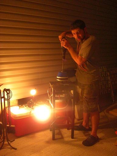

So today I managed to close the shell up and test the output with a drill..
I toned out the leads and attached the two bridge rectifiers. Rigged up another dog bowl with a threaded rod to turn the motor shell. I hooked up the output leads to an old trolling motor as a load.
It seems I am getting .6 amps at 44 Volts peak. 26 watts?.. Excuse my lack of fine electrical knowledge, but when I spin it with no load I get 44 Volts. When I spin it with a load, I don't even get 1 volt, but the motor definitely gets a lot stiffer under load. I assume the no-volt readings are because the load is absorbing the power?
At this point I am wondering if it is a better idea to just swipe the neos back and junk it, or continue with it. I was unable to count the rpms because it's spinning faster than I can count.

To get a good watt figure, you need to measure amps and volts at the same instant, and the best way is with a battery as the load and a couple of multimeters.
You have two AC circuits, and these are out of phase with eachother, so you need two bridge rectifiers. If you connect the AC circuits together you'll get less output. Connect the two bridge rectifiers outputs together +ve to +ve and -ve to -ve. Then connect this to your battery. You'll need a amp meter in line to measure the amps, and a volt meter across the battery to get the voltage reading. Then multiply the two together.

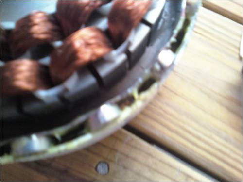

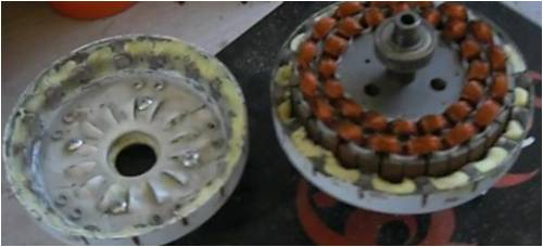

Since I was getting decent power, I decided to re-do it all today and do it right.. (or at least better).. So I ripped out all the mags and the dog water bowl and dremmeled everything clean.
I went ahead and used 64 neos (two double stackers X 16). I got them super duper close to the armature.
I made a mount by slop welding a 9/16 fine thread nut to a galvanized flange. The wires now run through the mount.
I followed through by using spray foam insulation to fill the gaps.
I closed her up and connected her to a 220 watt light bulb load. (100 watt flood light and 2 60 watters). Both phases are bridge rectified and connected + to +, - to -. Before I even get close to full drill force, the 220 watt bulbs max out.
It can push out more I am sure, but I am out of bulbs..
The case actually has enough room for another 32 magnets for a total of 96 magnets. But I didn't take it that far and I am out of magnets:)
There is definitely some cogging happening.. I am contemplating if I should dremmel the magnet edges to decog it.
