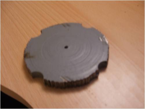

as a rough guide the rotors should be at least as thick as the magnets ... so for the 5mm mags a 5/6mm rotor should be pretty close ...there shouldnt be any magnetic effect on the back of the rotor...using thinner disks might allow this leakage ....plus potentialy physically weaken the alt...(possible flexing)...
with the rotors it is tempting (and maybe best) to bite the bullet and go to a machine shop , although prices can vary.....
the centre of the rotor below was cut out by drilling around first with a 3mm bit (more than one... ..) and gently jigsawing it out , the cut can be cleaned up afterwards
you do loose the will to live doing it
.....but it is an option at least for the centre holes

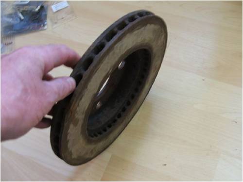

Posted: 02:42pm 04 Sep 2009
mmmmm.....as Gordan pointed out (and i didnt.....) the rotors need to soft iron or steel.....
another suggestion might be the old otherpower approach using old car brake disks
2 front disks and a rear hub would be needed , assemble it with 4 lengths of all thread ..this way maybe you could just concentrate on your stator ..i never tried one but there should be some reading on otherpower on the pros and cons
