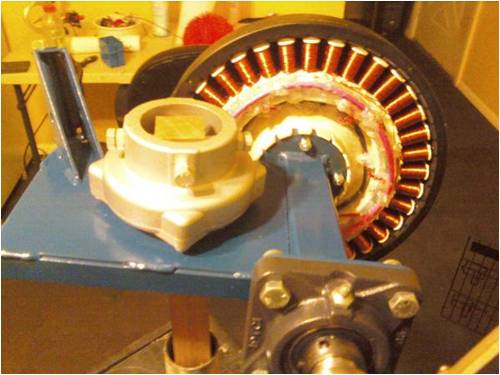

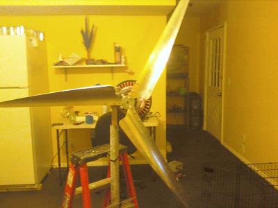

My F&P is almost ready and I have my charge controller and battery in hand. So now I am digging into the tower and mounting ideas.
Here's some pics of the F&P Turbine

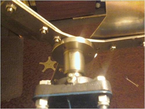

Just a note here floodrod. The bolts holding the blades appear to only have star washers. You may consider drilling the bolts and using tie wires, or using Nyloc nuts. Those metal blades will work on the fixings and probably undo the nuts with star washers. I saw a wooden blade go 80m. I think those metal blades would have more energy. Don't give the council a reason to make windmill permits harder to get.
Gordon.
