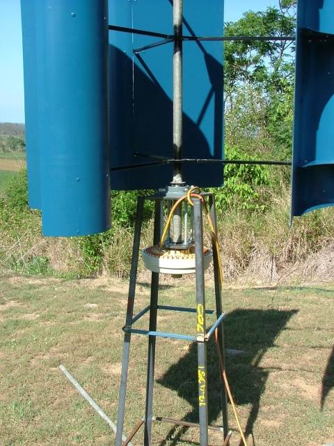

I decided to have another go at the Lenz2 powered F&P
I played around with this a few months ago, but had problems with noise. The F&P vibrats as it rotates, the large wings of the Lenz amplified this vibration into a very loud and annoying drone. So I turned the Lenz into a water pump.
But of late there has been turbulent wind here, the HAWT's havn't moved in months! I live on the north side of a hill, and for 6 months of the year the wind is from the south east. However the Lenz2 and another smaller sandia savious have run every day. The VAWTs are not affected by turbulent winds, unlike the HAWTs.
So I bolted a F&P back onto the Lenz, but this time I used a decogged stator. The lenz has a lot of torque, so would start a non-decogged stator easily, but I wanted to see if a decogged stator would reduce the noise.
Not much wind today, but when the Lenz has run there is no noise at all, so I might be on to a winner. I'm using a standard ( but decogged ) 80 series stator, and at 20 rpm I get 14volts DC, just enough to charge a battery. Hopefully tomorrow there will be some more wind.
Now I dont expect much from this, a couple of amps, 20 odd watts, but the point is, this thing could make a few watts in light turbulent wind, while the big HAWT is making nothing!
Will keep you all posted.

Posted: 09:13am 11 Jun 2006
Thats a nicely made looking 'mill there Glenn.
I wonder if even something as "trivial" as a rubber shaft coupling would help substantially reduce the vibration back into the "sounding-boards"!
Had reasonable breeze here today, nearly 4000 watt-hours out of my HAWT today, which is a bonus. Saved running the generator for a while at least!
Posted: 09:06am 14 Jun 2006
Yeah I think a rubber coupling would work. I have one floating around, somewhere
I connected a 3phase bridge rectifier last night, and dug up my trusty old Micronta digital multimeter. The Micronta has a peak hold function, so can be set to record a peak measurement while I'm away at work. This afternoon I checked the meter, 60 volts DC peak, meaning the Lenz reached over 100 RPM.
I've connected up a 12v battery, and set the meter to record amps. So tomorrow I'll be able to read peak amps into 12 volts, and therefore work out watts.
Then I'll break into the windings and reconfigure the stator into two halves. This will double the amps, half the volts, and then I'll do another amps/watts test.
I'm pretty excited about this windmill now. Remember, this windmill is close to the ground, at head height, and is working, while next to it is a conventional HAWT 7 meters up in the air, and not working!
Keep ya's posted.

Posted: 05:37am 18 Jun 2006
Finally got some figures from the windmill. I saw a peak of 1.8 amps, giving me 21 watts. Thats not bad at all, considering the horrible wind conditions it had to deal with, and it has a frontal area of only 1.5 meters square ( the big windmill is 3.8 meters ).
