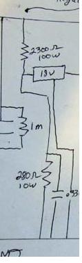

I know most of you use battery banks, but some may be interested in
grid-tie solutions. I developed my own IGBT shunt controller that stands
by in case I lose the grid. It will turn on if the voltage exceeds 235v and
divert the power to a dump load, keeping the voltage and blade rpm
down.
The voltage threshold can be set to whatever value one wishes. The unit
works off of voltage between 0 and 350v. I have tested it with an 8 ohm
load at 250v and it works well. I am providing a link to the webpages.
These pages also go into creating and developing your own circuit board
which some may find interesting and useful.

Hi imsmooth,
An 8ohm load is a serious amount of power at 240V, 7.2kW at full duty cycle.
If the grid is down, better to just use an interlocked relay, and electrically turn OFF windmill. I think what you mean is to provide a load during the time that the GridTiedInverter [GTI] is not connected to the grid.

I guess I was not clear. Sorry.
I tested the unit with 8 ohms and 30A. The actual load is 30 ohms/4000w which you can see in the schematics.
My point with the 8 ohms was that the IGBT could handle the large current at that voltage with no problem. I tested it with a voltage multiplier at 30A. I watched the unit cycle back and forth without a hitch. I would have tested it at 350v, but I didn't have my workarea set up for that kind of current.
The purpose my my controller is for when grid goes down. My Aurora has been pretty reliable so far and has not lost a grid connection. The inverter is a dedicated wind inverter, and has nothing to do with solar. What did you mean by a high static loading?Edited by imsmooth 2009-09-30

An extract from your pic.
There is about 100mA @ 250V. This is a high static load of about 25W. I keep the static control cct current to below 30mA @ 5V. I would power the unit from an AC plugpac, and have relay interlocks for power failure.

I thought about connecting it to the mains and using relays, but I wanted a self-contained unit. The unit only uses 25w at peak power; it is much less when the voltage is lower.
Is there a significant problem with such a high static load?

Hi imsmooth,
only 25W!! Before anything happens, this power is consumed in a dropping resistor. It remains the whole time the windmill produces enough power to feed the grid.
The current will be approx half, at half the voltage. I would expect that the inverter will have approx 180VDC minimum nom input voltage when connected to the grid.
I work on reducing wasted power to a minimum. I would think that the active parts of your cct could be selected to only draw a few mA. Probably could replace the 2300ohm resistor with a high voltage constant current source. This could reduce power by a factor of 10-20x. You are only using a zener sensing, so power supply would not be too critical.

Posted: 03:36am 29 Sep 2009
The problem I was trying to solve is that I need enough current to rapidly charge the IGBT gate's capacitance to rapidly go to saturation. I wanted the device to function without any external (grid) voltage source, so it had to develop a stable voltage to power the ICs over a large voltage range (0-350v). THe 2300 ohm resistor allows the 18v voltage regulator to do this.
The shunt controller, and hence the 2300 ohm resistor, is not in series with the inverter. It is in parallel, so nothing interferes with the inverter getting power.
The inverter feeds to the grid starting at 50v. That's only 1w. At 100v it's only 4w, and at 150v it is 9.8w. I know I am wasting power, but I didn't see a way to solve the problem:
1. be able to turn on if the voltage exceeds a certain threshold with or without the grid being active
2. turn on at a specified voltage (234v).
If the grid is down, I still need to be able to shunt power. If the grid is active, but I have not established a connection I still need to be able to divert power. If the voltage exceeds a certain threshold I will destroy the inverter.
However, if you have a better idea, which I am always interested in, I wouldn't mind seeing a schematic.Edited by imsmooth 2009-09-30
