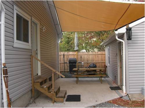

floodrod
Joined: 08/07/2009
Location:
Posts: 70
Posted: 11:59pm 06 Oct 2009
I don't like the plywood part too much, but I like the results you show.. I have a bunch of tensile structure fabric left over which is rated for ice/wind load for 20 years.. It's stronger than trampoline material and air/water tight.. it's like 30mm cross woven pvc coated polyester.. Im pondering the ideas of building a pipe frame with that material as the deflector surface..
Keep me updated. I like the ideas you share
EDIT: Here's a pic of the fabric I'm talking about over my patio..
Edited by floodrod 2009-10-08
faroun
Joined: 18/09/2008
Location:
Posts: 62
Posted: 12:26am 07 Oct 2009
not bad.. not bad. a pipe structure could do the job, i did try it with out the half pvc and the wind did not channels down properly, that could be an issue with the fabric build!!??, but i always say "I must try it first" so anything is possible.
i will keep you updated for any modifications...
thanks
