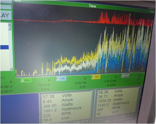

Well ,another day blowin a gale , I swapped the blades from the F&P onto the Ax the other day and put the old ABS blades on the F&P Dual . With the blade dia now down to 3.1m I figured it would not be able to get to the highs it had a couple of weeks back before the blade let go .
Wrong again with a blast of wind coming through at 57klm it punched through 3 Kw ( 3197w @ 576 Rpm ) shown below the recording on the piclog.
I have had it down quite a few times today to keep reseting the furling moment and have been keeping a eye on how hot it is running and after quite a long period of high output , I was still able to hold my hand on the housing for as long as I wanted , and no smells of heated resin coming from inside , which is a good sign
The furling now is starting in 25 to 30 klm and is fully furled at 40 , but even in the fully furled position it is punching out arround 2Kw .. But the best thing is when the wind dies down to nothing and the Cap/doubler/quaddrupler takes over and keeps the power flowing with out stalling the blades , No complicated star /delta switching or mppt tracker..
I have been in the design process recently of a bigger Ax Flux on a 400mm stator dia , but after the last couple of weeks and thinking if there was a bigger one up there in these winds it would have to be permantly shut down , there is no where for the power to go as the PVE 1200 is at its max coping with this one and the F&P dual , but in this wind I can't stop the F&P even with the 2.8m "Howling Banchee" Abs blades where its a flick of a switch and the Ax stops

Hi Phill,
The 3.1kW from a 3.1m rotor is getting pretty extreme. How is the stator handling the abuse? There were worries that the enclosed design would cook and burn up. I have not been able to check mine for signs of heat yet. My coils are hollow, so there is a larger surface area for cooling. The windmill must still be above 90% efficient at 3kW, or else I would expect smoking coils. Probably need to see how fast the stator rises in temp with say a fixed current through the coils at say 10A.
I expect that the windage factor at the 400-500rpm would cool the system quite effectively.
s
hi mate . can you tell me what you are using for data capture ? is that a USB connected oscilloscope on your computer ?
and also , is there more detail somewhere on the AX FX construction you used ?
.. and the circuit you are using for the cap doubler ?
trying to find ways to improve bottom end start up in the low wind range and lift average power production here with AXFX.

Hi Perry , Heads
The data logging is done by the Picloger that Glenn origionaly designed , this one I have is a dual piclog and was modified to suit 48v and tricked up a bit by Gordon as is the cap/doubler setup , both these are in the main page info somewhere .
There is further detail on how I built the Oz Ax Fx in a post called Homegrown Ax Fx . It was designed with lower resistance to use the cap/doubler to get the low wind power then at 200rpm its raw power with max efficiency and very little stator heating.
Yea , Perry these blades can really deliver the power , I have always said " no power in = no power out " . I stuffed arround for years wasting my time trying to build a good blade , I thought my ABS pipe blades were good untill I tried these . Would't waste my time doing all that again ..
