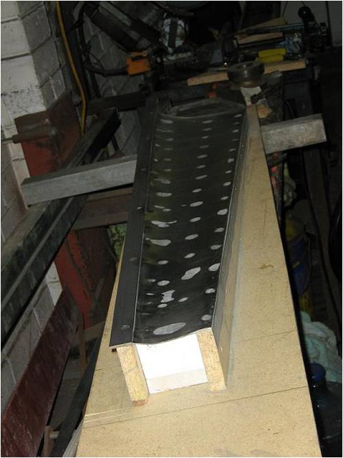

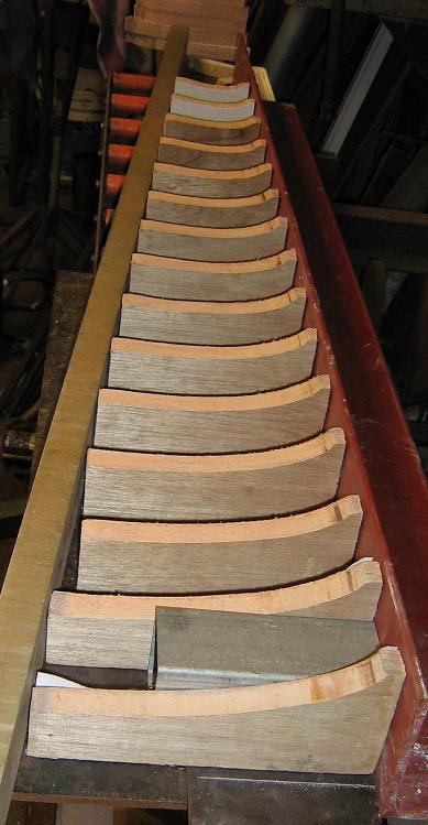

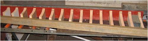

Last xmas break I had a go at making a set of fibreglass blades.
I had no real idea what a set of mill blades should look like and after a lot of internet searching found a actual size printable template guide for the blade profile.
The profile was for a 800mm or something length blade, I wanted 1200mm length.
I used the profiles and spaced them a little wider apart to make the 1200mm.
I don’t think this is the correct thing to do, but what the hell I was only intending to see if I could actually make a blade in glass and find a way to do it.

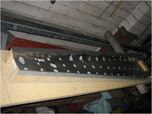

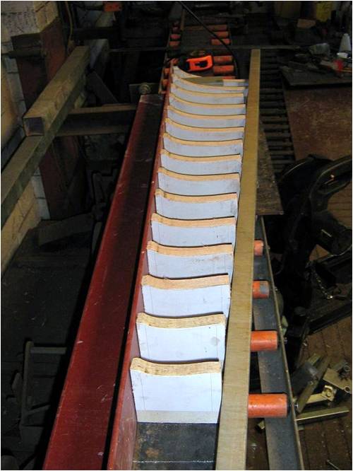

The paper profiles were printed and glued to some blocks of wood then cut out with a jig saw.
The blocks were spaced evenly and after some trimming of block lengths. They were assembled in a frame.

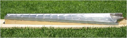

sheet metal was then skinned over the blocks buy using the blocks to form the shape.
The sheet metal was cut to size and then clamped down onto the blocks at one end using the opposite cut half block to form the shape. And the same done to the 3rd block. I then nailed the sheet metal to the second block. Moved to the 4th block and clamped it down and nailed the 3rd block down and so on.
This gave a ok result but i would shape the metal somewhat first if doing it again.
The nail heads were filled over with auto bog and sanded back.

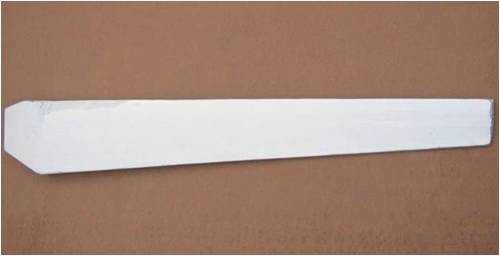

A flat metal plate was added to the back as a guide to cut the glass off cleanly along.
This was done when the resin had set but before it had hardened (30-40 mins in summer)

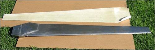

The root end was made and soldered onto the blade profile.
It was polished up and waxed ready for a lite coat of gelcoat
After the gelcoat had set, 3 layers of 450g /m2 chopped strand glass mat was resined onto the gelgoat.
When removed from the mould the first result was pleasing.

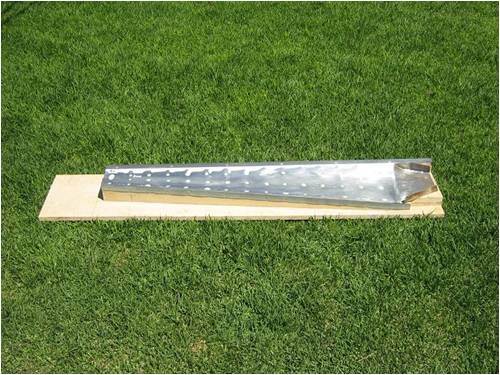

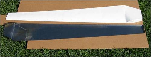

I made a sheet metal mould to fit on top of the bottom mould by shaping a lip on one side of the cut sheet metal coming back to a flat sheet on the trailing side.
Metal top half of mould and bottom F/glassed half

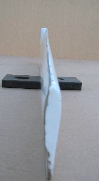

A root end piece was then made to mirror the bottom half and the two bits soldered together. I now had a one piece top half to match up the bottom half.
This was then waxed and gelcoated and once hardened 3 layers of glass applied to it.

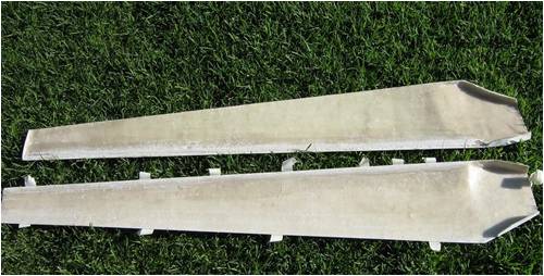

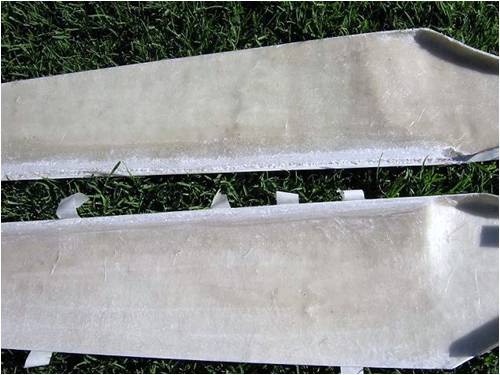

This is the two halves removed from the mould and sanded to match one and another.

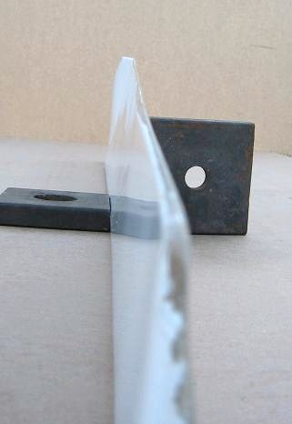

A flat lip of glass was added to the inside of the leading edge side of both halves so when stuck together there was a reasonable area to bond to, it also added some rigidity to the blade.
The trailing edges basically face up flat to each other for a inch or so inwards from the edge.
The root end had some blocks of form ply cut to fill the root end void area for mounting strength and was glassed in prior to assembly.

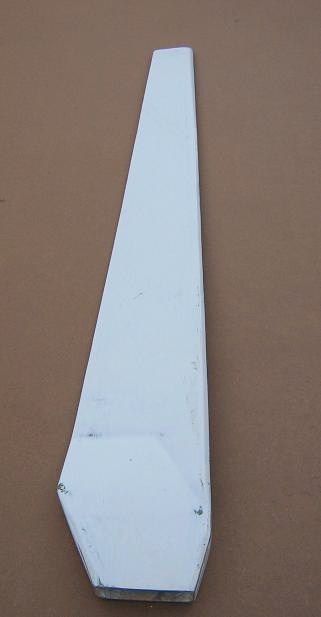

The blade was put back into the bottom mould for support when the two halves were stuck together with resin and clamped tightly.
Overall it yielded a blade I felt worth while to do a full set of 3.
I made 3 more blades and kept the original blade as a template should I need to make a fibreglass mould off of it in the future.
The surface of the blade has a few uneven spots in it from the sheet metal shaping but not enough to worry about.
A bit of care with keeping the glass mat even in quantity and the resin amount even per blade throughout kept the weight reasonably even for all 3 blades.
I can flex the blade over my knee by about the same amount as a broom handle without snapping like the broom handle.
The blades have not flown yet as the intended mill is still down from earlier maintenance and ready for a blade refit.
I am not totally happy with the top half transition point between the root and the blade and if was to make a mould from the proto type I would fill and reshape this section. Otherwise happy with the overall results.
