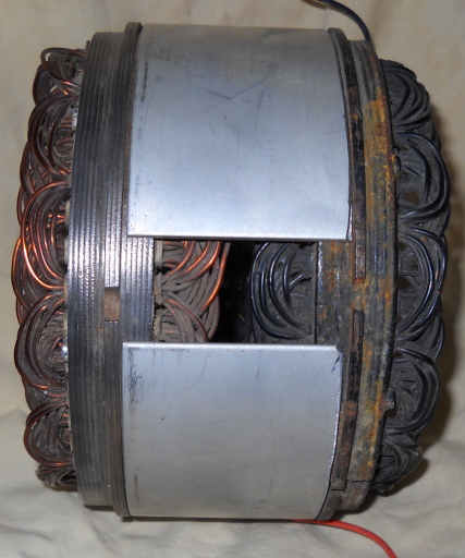

I am talking with some friends about stretching the case on a gm alternator(10 or12 si) to accept 2 stators. Is there any problem with how close to each other the stators are?
I was thinking 1/4 inch between them max?
This would make a system similar to The F & P doubles.
The stretched alternator should wind up around 2 inches longer than stock. There is one problem with the fit up but I think I can work it out.
We could use two permanent magnet rotors or make a new one long enough to serve both stators. Install magnets to suit.The GM Alternators are still readily available in the USA. I have a couple pictures on Bubs camera Ill try and get up in a day or so. This resizing the pic's is a pain.

This is a tentative Idea.

Posted: 03:33am 17 Feb 2010
MacGyver
If you get a stator for 24 or 48 volts and a permanent magnet rotor it will cut in much lower
Bub has one with the 24 volt stator and one of those rotors off ebay
that puts out useful voltage at 200 rpm.
Thus the Idea for two stators one wound for low wind the other for average wind speed.
We figure on putting the rectifier and caps or what ever down at the combiner box.Edited by isaiah 2010-02-18

[quote]Thus the Idea for two stators one wound for low wind the other for average wind speed[/quote]
Take care to bench test it in this configuration. The F@P does this quite well because of it's high armature reactance.
This means the low wind winding, "current limits" when the big wind turns up,(and protects it from burnout) and a different stronger stator could take the bulk of the remaining power (with much less turns and higher rpm).
In a car alt with strong neo's, it may not current limit before burn out of the low power coil, as reactance may not current limit it soon enough to keep it safe.
just a thought.

[quote]Oztules
What is reactance ?
What is the 3 in hand of rewiring the coils on the stators?
How dose one ever keep track of all those turns and that you got them wound in the right direction?[/quote]
1. Armature reactance for these purposes works like this.
You have your neo magnets in the rotor that put out X lines of force that act on your coils. Open circuit voltage may be say 12vac @ 200 rpm. It is because of those lines cutting the copper turns of T turns, that we get a certain EMF generated in those coils.... this gives you your rpm/volt.
Now we put it under load. Not just volts (EMF) are in the copper now, but current is flowing as well. Flowing current generates a magnetic field around itself. It will work in opposition to the magnetising force (the neo's). This degrades the value of the X flux lines, as now we have X-(whatever the stator is now opposing it with.)
The nett result is that we have less lines of force to actually cut the copper now, as some of them have been repelled... so we now get less voltage (EMF) generated in the wire, and the terminal voltage will be the generated EMF-volts lost in the stator via current X resistance.
You can see where this is going now, the more we draw current out of the stator, the more magnetic flux lines get deviated away from the stator, and more insult to injury is the volts lost in the coils goes up as well... we lose everywhere.
Now this "reverse" magnetic field the stator is making in opposition to the Neo magnetic field is called back MMF (magneto motive force). It's value is proportional to the Ampere Turns. So the back MMF goes up if the amps increase or the number of turns increase. We can't change the turns on the run, but we can certainly increase the amperage by increasing the rpm.
It will get to a point where as we get the rpm's up high enough, that our back MMF will oppose the neo field so much, that no matter how much faster we spin it, no more power is forthcoming.... we are now current limited. The amp turns are now such that we can get no more EMF into the coils because we are repelling enough flux to achieve an equilibrium....
Now if we have the turns and wire size and sufficient heat sinking from the stator iron (F@P) right, we can do this indefinitely, and not burn out the stator from the I^2 R losses in it... If our neo's are strong enough, and our turns low enough (amp turns remember), we may not get to current limiting before our low efficiency stator cooks.
An F@P has feeble magnets and good cooling and high turns count.... it will probably current limit before burning out. A car alt will have much less turns, and big neo's. Much harder to deflect the field away from the stator.
So if you wind a low wind speed stator, it will have lots of turns of thin wire, and become subject to much greater I^2 R losses..... heat.... poof....
So long story short:
If you design it so that your flimsy low wind winding will current limit at say 5A, and no matter how much faster it spins, it will always be 5A, then it can't burn, and the big wind winding takes over. The little one will continue to contribute the 5A as well... win win..... otherwise as rpm increases, the little one will eventually cook unless this happens.
2. 3 in hand means using three spools of wire and winding them onto the coil former as if they were one... ie. 3 at a time.
3. You keep track of them because the three wires are treated as one.... 3 at once as if they were one only.
......oztules
