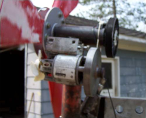

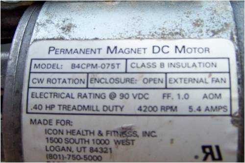

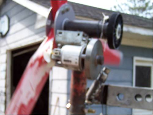

Gary
Joined: 02/04/2010
Posts: 14
Posted: 04:48pm 02 Apr 2010
GreenD88-
I guess I misread the motor as you can see...it is a .40 not a 40.....
here are some pics of it...
Thanks,
Gary

Downwind
Joined: 09/09/2009
Posts: 2333
Posted: 05:03pm 02 Apr 2010
Its not an over large motor for the blade set you have and with a 1:4 step up ratio it will take 4 times the wind speed to start it compared to a 1:1 ratio.
Any cogging effect or drag will 4 x greater to overcome.
Looking at the photos it dont look like a 1:4 ratio.
Pete.

niall1
Joined: 20/11/2008
Location: Ireland
Posts: 331
Posted: 05:46pm 02 Apr 2010
hi Gary...
those blades do seem very similar to the ones i had....if their the same batch they probably have a fairly high tsr and minimal twist ...unfortunately this isnt going to help their start up much
even with just hub bearing drag higher tsr blades can take a couple secs to get going...not much grunt in there till their up to their ideal speed
maybe try 1:2 as an experiment ? ...feel her out a bitEdited by niall1 2010-04-04

DTV004
Joined: 30/04/2009
Posts: 65
Posted: 01:39am 03 Apr 2010
i have the same blades the don't work. you have to have hi wind all the time ..ps:try from pvc pipe
