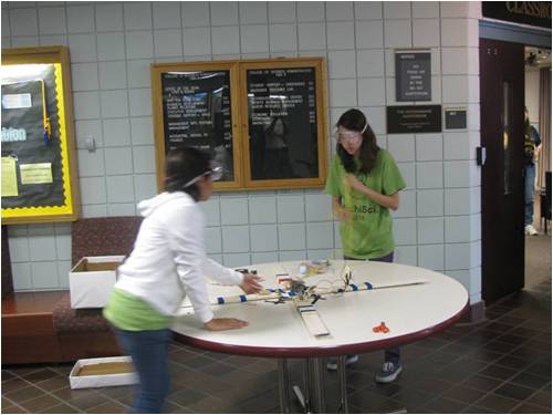

Hello everybody, I’m so happy because on Saturday I won a medal at the Florida Science Olympiad in Orlando Florida USA. My team won First place! So we’re going to represent Florida at The National tournament in Chicago Illinois.
I want to thank to everybody that helped me in this project! Especially to Pete who took his time to teach and explain me how to build a windmill, all the concepts and definitions, all the terms and vocabulary, all the tricks, measurements and good ideas.

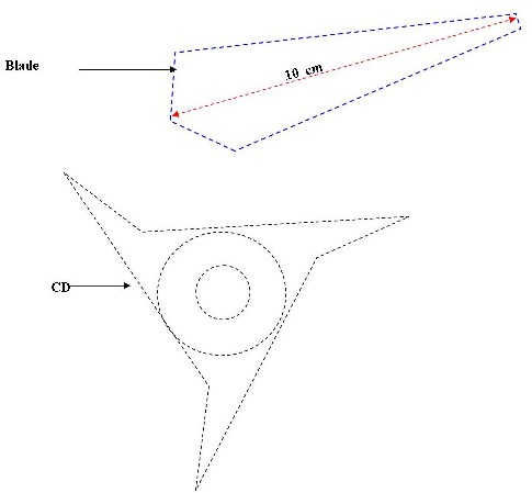

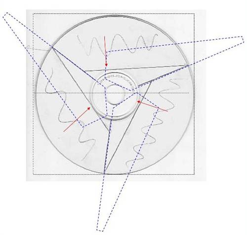

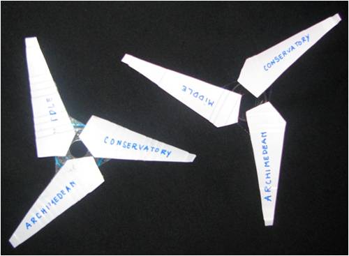

I will clarifire what Gaby needs for a blade design.
The max dia is 250mm (10") it needs to be mounted onto a CD and the hole must not be modified but the rest can.
There is no metal allowed to be used.
The most important part is it will need to work well, in turbulent air as it is tested in front of a fan.
The turbulent air is the killer here as it messes everything up.
Do any of you have ideas for turbulent air blades.
The quest here is for the highest rpm possiable but starting up in turbulent air is a problem.
Pete.

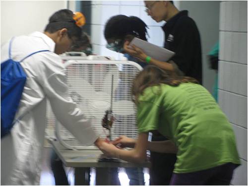

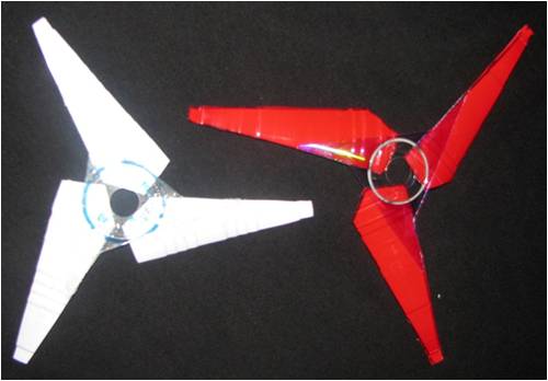

Here you have some pictures of my minimill, to have a better idea as Pete said.
Turbulence is my problem ... When the windmill raise a 1000 mV the blades start to fold. I already tried with some plastic materials but these materials increase the weight and reduce the velocity.

Try smearing cheap superglue on both sides of the paper (1 side at a time and allow for drying) of the area that requires the extra rigidity. But take care as superglue produces dangerous fumes and plastic gloves would be handy as well for skin protection. Experiment first to see how it works for you.

Hi Gaby,
This is just a thought but it looks like you are testing pretty close to the fan. Turbulence takes on many forms. It may be that this close to the fan there is an angular component to the airflow.
You might want to try to build a rotor that spins the other way. Do a little testing and see if you get better performance if your turbine spins the same direction as the fan or in opposite direction. An easy test with materials you already have.

Fit a shroud (like between a car fan and radiator) with the straws held by the shroud in front of the generator. That may remove the turbulance and concentrate the air flow to the generator blades. Have the shroud larger than the blades. The venturi effect may give a boost to power output.

Blade rotation direction may have a part to play if driven by a fan
Did you have a nose cone?
