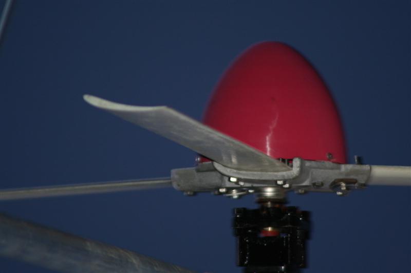

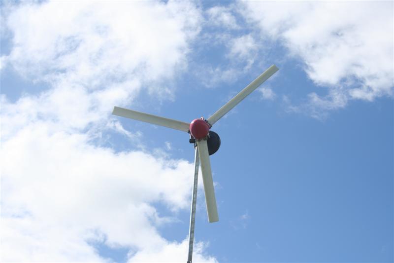

Hi Dudes I have been asked to upload some photos of the blades im using..... they are from http://www.ecoinnovation.co.nz/
Nad the link to the blades
http://www.ecoinnovation.co.nz/product_detail.php?id=208
At around 35kms wind speed im get up to 35 amps @ 15 volts
Soon I will be logging the Turbine here as well (icon to be added) i have a Weather Station here as well
www.subznz.co.nz

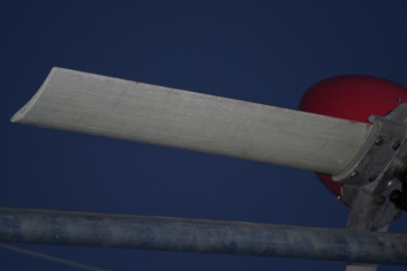

your blades arent tapered at the end.
why have them square like that?
why have them tapered?

Well good question thats how they came and the guy that sold them to me would have to be one of the leading experts around here in New Zealand Please note they are made in China and the price was great for what you get
Im very please with the blades they are so quite and 550 watts + makes life easy   but if you have any way of impoving them would be more than keen to know
Out of intrests these blades are bing tested in one of NZs bigest wind farms in the Manawatu and sound like they are profoming well

Hi an update on the blades they in in bits after we had 90 kms gusts here at home NZ Taranaki the blades flexed back about 200 mm and hit the pipe and was all over now I have to work out how to make more room may be tilt the mill up 2 or 3 Degs other wise its a total rebuild of the gear   It was based on the backshed setup   Any good ideas ??
Thanks   Bevin
Posts: 5188
Posted: 10:19pm 05 Oct 2006
Wow thats some serious wind. Was the windmill furling out of the wind? If not then the tail was too heavy.
200mm of bend at the blade tips is a lot, furling will fix the problem.
nzseagull
Joined: 07/06/2006
Posts: 17
Posted: 10:57pm 05 Oct 2006
Hi Glenn
Yes its furling ok but the gust were major big time all a bit sad really
Think it just got hit hard and fast

Hey guys was thinking of tilting the bearing housing upward 1 or 2 degs to give the blades more clearance from the mast
I will need to cut and re weld the bearing   but would be easer than trying to extend the shaft some how   ?

One suggestion is to turn the mill into a downwind mill. No rudder and no furling. If they flex then, they will move away from the mast.
Disadvantage: Shadow of the mast.
If these are PVC props, then they will regulate themselves through a stall and not overspeed. This is why I believe they will self-regulate.
A prop with no twist and no taper. Last time I saw a thing like that it was an extruded aluminium prop, which was sold commercially on the net. You bought it by the meter (~yard).

Well been looking hard into the blade cleance problem and look like what they do is tilt the blades backwards 1-2 degs that will sort the problem have found a few wind tubines that do this to keep the weight in the center
bevin
