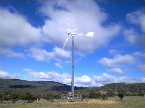

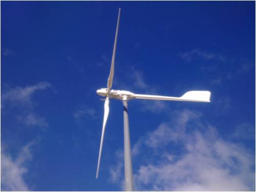

On my way to Thredbo yesterday i noticed two large turbines and just had to go and have a look. I spoke with one of the owners and they are 10kw. At $63,000 each i think i would have put in a 5kw turbine and spent the rest on a solar array. Either way they look good and will make people think about generating their own power.

They look like "Exmorks" . how tall do you reckon the tower is ?
and were they turning?

Yes at first glance Exmork is what I came up with?
Monopole towers, BIG $$$$

If it's a 20 foot turbine then I'd say from a guess 50 foot tower and if it's 32 foot turbine then probably around 75 feet tall.
Just guessing though....

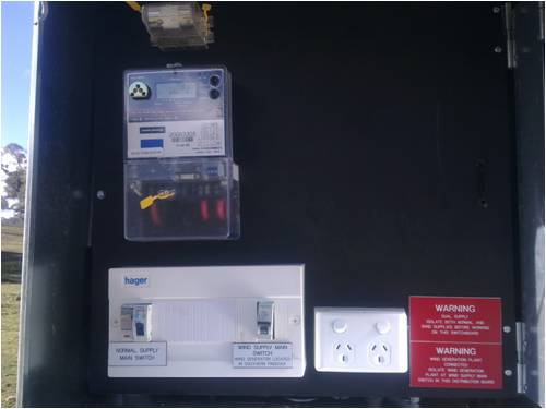

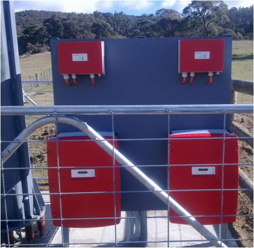

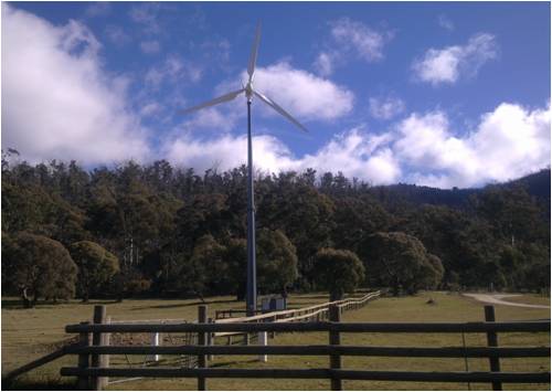

The towers were about 10m - 12m high , The first one was turning the last one (photo) wasn't. I thought they looked like exmorks aswell, the controllers were windy boy (sunny boy related i presume).
They were getting 63c / kw.

What diameter where they? 16'?

Yes i would estimate the blades are 5m diameter.
The pole is two 6m sections so the blades appear to be 3m long each.
