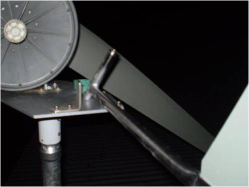

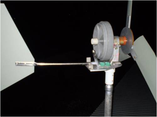

Looking at your photo there seems to be no furling and just a tail stuck out the back.
This is wrong and needs the tail offset.
There is many adjustments you can make to the tail but you need to get the basics sorted first.
Can you give a photo of the tail setup.

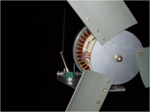

Ok, I have just gone up there in the dark and taken these, they are blurred because I couldn't see anything I just pointed in the right direction.
Looking from the top, down, the centre distance between the shaft and tail is 150mm
and the pivot point for the tail is 20 degrees in two directions.

It is hard to tell, but do the pivot for the tail slopes backwards only or back and to one side as the first photo shows it leaning to the right.
The tail pivot should slope backwards only at around 15 degrees towards the tail, not left or right as well.
The photos are clear but the angle is hard to tell.
Pete.

Joined: 12/05/2009
Posts: 49
Posted: 01:42pm 18 Sep 2010
Hi Pete, it slopes backwards 20 degrees and looking from the front slopes 20 degrees
to the left, I'm pretty sure I got this information off this site, the bachward slope is fixed however the side slope is adjustable to upright. Thanks for any info.

Posted: 04:21pm 18 Sep 2010
Yes i think you are right with your tail pivot.
Back to the tail.
A larger or longer tail will have a greater dampering effect, so can adding weight to the tail.
Adding weight will depend where you put it, the further out the tail the less weight required.
I see tail length/size as a coarse adjustment and weight as a finer adjustment.
Pete.
