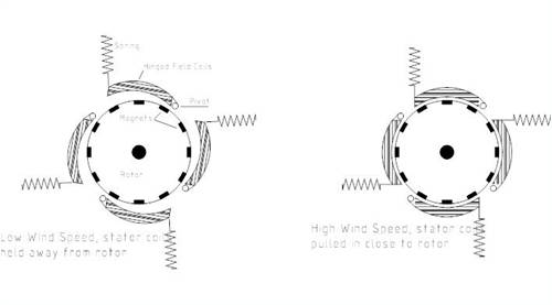

Your thoughts on this idea would be apreciated.
Would this work? Would the mill pull the stator coils closer to the rotor as the speed increased? Would cogging be reduced? Would there be any benefits at all? or is there nothing to be gained?
The opinion of great brains of this forum would be appreciated.

For 1) it would be only an advantage to a iron core machine.
2) there is better ways to overcome cogging i would think
3) if the magnets relied on centrifugal force than it would work against itself.
4) to go to the trouble to build a mill with this system, it would be far cheaper and more practical to build a AXFX mill and not encounter the problems you are trying to solve with this system.
5) its just one more thing to fail?
Thats just my 2p worth.
Pete.

John, Pete's right; concentrate on building an axial-flux rig.
I'm a bit of a maverick when it comes to following the leader, but after several failed attempts to build a wind generator "better than the one everyone else is building" I've come to the conclusion that the axial-flux is already the best around. I think it might just be as good as it gets in this lifetime.

Mac, while everybody emphasizes the "axial" flux thing, what basically makes these machines so successful is the ironless design of them.
There is no reason on could not use a 'radial' flux ironless design. Sure, the stator would be a little more complex to make but that could be overcome. The magnet mounting would, IMO, be actually simpler and more efficient.
