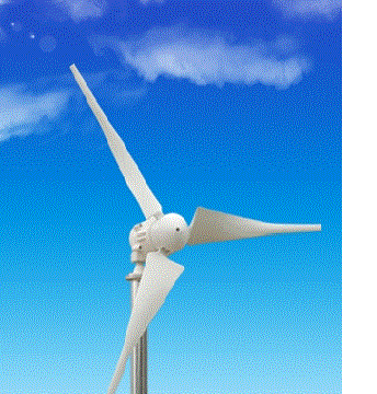

I bought sometime ago a small (400 watt) downwind generator. Its design looked interesting and has a furling system because the generator is off set from the pivot point. After spending time building a controller (see other posts in electronics)
I was looking forward to producing some power. Nothing, absolutely nothing. I have mounted it in my pillar drill at 480 rpm. Testing the voltage between the phases shows 40 volts but no amperage. The voltage measured across a rectifier is 15.6v but this was measured when it was mounted on its mast. There is connectivity between the phases as tested with a multi meter set to resistance. Does anyone have any idea what is wrong and how I can resolve the problem?

  Shelly said   I bought sometime ago a small (400 watt) downwind generator. Its design looked interesting and has a furling system because the generator is off set from the pivot point.
Hi Shelly,
the offset you mention would likely be just that needed to allow the downwind mill to track a changing wind direction. The Skystream has a similar offset. There is an additional offset between the mill axis shaft rotation and the Yaw pivot. This may provide a furling moment.
The windmill will not produce any amps without a loading. If you can explain how and where the measurements were taken, and if AC, or DC was measured. Can the metering measure AC & DC, volts and amps.
A picture may help as well.
Gordon.
PS is the windmill an Aladdin 400 like this?
Aladdin 400 site

Yes this is the generator. The gen was originally connected to a large battery bank through the supplied controller. I ditched the controller and put in its place the controller that has graced the electronics forum. There was no difference. There is an ammeter in the wind gen circuit that even in a strong wind has never shown a charge of more than 1 amp. The only voltage, apart from the battery voltage, was taken across the the rectifier (one phase to -) and read 15.6 volts. This was DC. The 40 volts taken across the phases the other day was AC. The gen is now in pieces and there is no sign of damage to the windings and the stator doesn't appear to touch the windings. There is a lot of cogging and if the phases are shorted the gen stops or is difficult to turn. From this I presume there is not a lot wrong with the gen, but it doesn't explain why there is no amperage. The gen has been installed for several months on a 10 metre mast. I don't live in a high wind area but occasionally we have strong winds.
I live off grid using solar panels as the prime charger. The wing gen was to have been used as a backup on overcast days.
I'll take a couple of photos tomorrow of the gen in pieces.

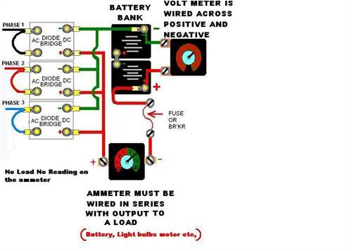

-A couple of thoughts come to mind, #1 are you certain your diodes are not damaged?
they could be shorted internally rather than open.
As Gordon has noted, if there is no load the ammeter will show nothing.
#2 Is the ammeter connected in series with your Load?
Here is a modified old post of mine showing my thoughts on a proper hookup.

The gen was wired up as per your diagram. I am now going to dismantle the wiring to make up a test rig to try and sort this problem out.
As far as the rotational speed is concerned at 480 rpm in the pillar drill should have produced around 25 watts. The amp meter read 0.1 amps. I have used 2 amp meters and both showed the same.
