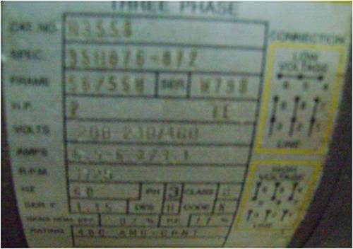

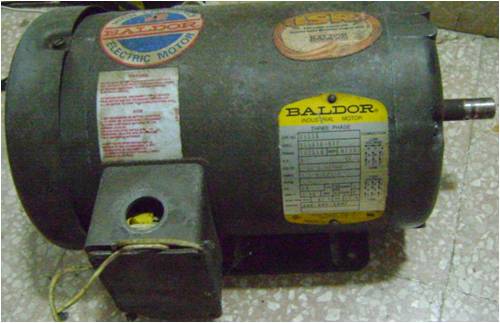

This is the 2hp three phase motor that I will probably use, I do not have a pic of the axial flux alt because I have not started it yet.
VIDEO OF MY VAWT TURBINEEdited by charlie_ruizpr 2010-11-06

hate to be the bearer of bad news charliee but the vawt will need to be 10-20 times what you have now to gear that moter up and drive it and the only way you will get that rpm out of a vawt is with lift or counter rotating. It will be a real showpiece when you are done

I had seen it already and liked the design. I was told that for me to use this motor as a generator that I would have to make a conversion, can anyone tell what is needed in this case to be done?

Posted: 05:34pm 07 Nov 2010
