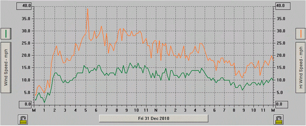

this graph is data from my weather station. The data is for a single day 311210, and consists of typical 10min averages [144data points for the day], and the maximum value for each period, plotted together on the same graph. The maximum reading for the day was 39mph, and the minimum was 4mph.

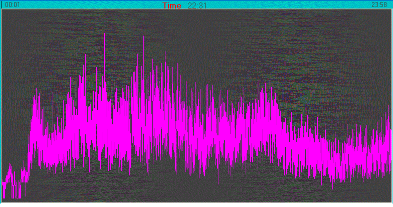

this is the same day period for 311210, from my windspeed logger. This consists of logged 10sec averages [8624data points for the day]. The maximum recorded reading for the day was 31.4mph, and the minimum was 0mph.

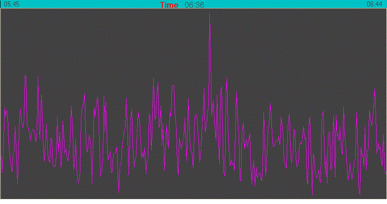

The data for the day is quite difficult to view on a graph, so here is a selected 1hour period.
I have crunched some numbers, and a median windspeed for the day based on max/mins, is 21.5mph. The same data gave an average of 11.247mph based on 10min averages, and 20.833mph based on averages of the maximum readings during these 10min time windows. The average windspeed based on 10sec readings is 9.729mph.
My 2 windspeed measuring cup anemometers [Davis type] are within 1m of each other, so essentially measuring the same airspeed.
There is approx a factor of 2 difference in the data from the different measurements. Unfortunately this reflects an 8fold difference in wind energy based on the data.
We often think a location is windy, but without a standard comparison of measurements we can be very dissapointed when the windmill does not seem to make as much power as was estimated from the data.

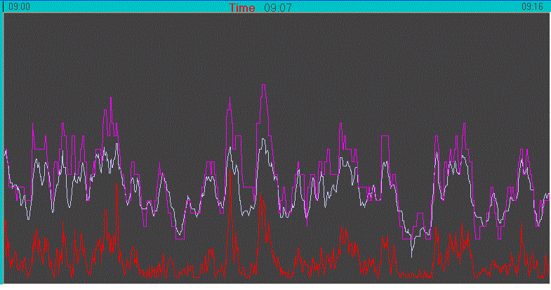

Anyway, re correlation between a windmill rpm and windspeed.
Here is a graph showing my windmills rotor performance relative to windspeed. This data was logged at 1 reading per second, so this is the limit of timing accuracy.
The whole point of a windmill is for the rotor to track the windspeed quickly. There is no point in manipulating the windspeed measurement to suit how a poorly tracking windmill works.
In the graph above the top graph is the cup anemometer windspeed measured data in purply-pink. The light blue is the windmill rotor rpm. The red graph is power into the battery loading.
I think you can agree that there is good correlation of the rotor rpm to the changing measured windspeed. This is the intended outcome. If there is lack of response of the windmill, this will show up with a time difference between the graphs, and reduced maximum rotor rpm's obtained compared to calculated rpm v windspeeds. If the windmill rotor has high inertia, then this will result in sluggish rotor response to the changing windspeed. My windmill does not show this problem. Rotor Inertia is an undesirable feature of a windmill and compounds problems with electrical capacitance and the ability of a control system to make changes to get optimum power from the wind.
I would prefer, and have a windmill that captures the bulk of the wind energy that passes my home. The windmill I have, rapidly changes speed, as seen by the graphs, to follow the windspeed. During storm events with high peak wind energy, my windmill ignores the peak energy now. Soft furling and rpm limited by loading has resulted in wind energy shedding during storms and reduced the need to process power electronically during these times. The weather data recording has shown that storm event wind energy contributes little to maintaining the battery, and only places significant demand on electronic power diversion systems. The few percent of the time that storms play a part does not justify the effort and componentry in capturing every last watt, with the potential to test all the special seals that keep the magic smoke in.
I feel that averaging highly dynamic data [like from a windmill] too much, reduces the information it contains. Averaging the windspeed compounds the meaningful calculation of energy available from it as well. The accurate measurement of windspeed in close proximity to the windmill and a reasonably fast measurement of key windmill parameters can show if a windmill is working optimally or not.

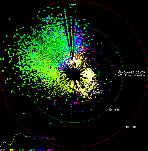

I took a rather different aproach to visualising the wind....
Basically, I sample the wind every 5 seconds. I then display its speed and direction by plotting a dot at it's position on the "rose". In order to see the third important element - time - I colour code the time over a 24 hour period. There's a little line graph at the bottom that shows time/colour, and wind run for each minute to give an idea of windspeed trend.
It conveys a lot of information at a glance, once you get used to it.

Hi Ross,
This looks like a pic of the south pole.
This is similar chart info to a Met. wind rose. The coloured timebase adds a nice touch.
I have wind direction available as well on my wind sensor, but I don't normally log it, except on my weather station. Are you able to change the timebase from a coded 24hr period to say an update of the rolling last 24hr period?
The dot chart I use for plotting windmill power v rpm or windspeed could be made to output similar information as a part of my windmill analyzer. I would consider adding this if you did not mind.
The addition of (c) info embedded into the chart is a useful touch as well, for publishing, that I don't currently do.
Real time graphical data update is so useful. I think that a reduced timebase may be good as well, as In my own plotting I have found that the most recent data is hard to see in amongst a sea of dots in a 2D and 3D representation. I also notice that Glenn has added a real time graph to the PicLog program. I found that when I added real time graphing to my windmill analyzer that I had so much more info available without needing to manually delve into historical data. Clients using my analyzer found this really good on the public viewing screen.
I think that having some sort of standardized visual data format would be very useful. Comparing aples with apples would certainly clear up a lot of confusion with weather and certainly windspeed data.
The wind direction does not change the amount of power my windmill makes. Logging wind direction has been a low priority for me for this reason. Displaying the full wind data on a single chart would be most useful in looking at seasonal changes of wind patterns. The raw logged data from my Davis weatherstation is binary encoded, so extraction of the basic data will need some work. I have records going back to 2005 so a wind rose viewing might offer fresh light compared to overlaying strip charts. I should add wind direction to the suite of parameters I now log. It is certainly easier to view day to day, or month to month trends with a dot graph like you have done.

Hi Ross
Thats a nice touch and it sure adds dynamics to a graph for a presentation.

Heh! It varies a lot... the "hole" in the middle is because the commercial weather station I'm using simply doesn't read below about 3kmh - hence nothing in the centre.
[quote]
[/quote]
The BOM roses actually have a lot less info. They're taken at a particular time, or represent a few specific snapshots at different times.
[quote]
[/quote]
The graph you see above *IS* the last 86,400 seconds (24 hours) - and is always shown as a rolling interval. I also produce an hourly version that is much less cluttered and shows a "recent history". I have an archive there too, that lets one go back to pretty much any day in the last 6 or so years and see the temperatures, rainfall, wind etc for any day. (And yes, I do keep the 5-second wind data in perpetuity - I have to reproces it, but I also have the every-minute data going back to the mid 1980s that I will put online one day).

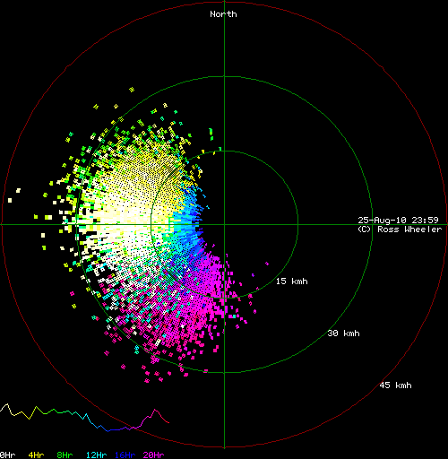

Yes, but you really see the effects of aproaching/passing fronts and storms, changes in air masses etc!
Example, here's one from 25-August last year:
Observe how clearly the wind moved over the day from SSW through to WNW, and got a little stronger - mostly "reasonably" steady wind, with the odd gust to nearly 45kmh
