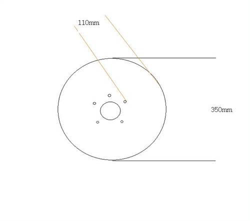

I am looking for a little advice on magnet spacing and mag size for a mill?
The 2 metal disks i have are 8 mm thick.
I have decided to give one a go.

Hi Amack
i looked up Hughs specs on his machines ...its cheating a bit ...
at 8 mm and 350 D thats pretty close to his to his 2.4M machine ...the 3M machine uses 10 mm disks at 350 D
i,m really hoping others with experience can come in here and discuss the magnet choice and coil (turns) layout .... maybe 12/9....
nows the time to figure it out ... ...... Edited by niall1 2011-02-10

Thanks Niall, I think you are close to what I had in my mind to do. I have had a look at Hughs book and I do plan on using 12/9. I would like it set for 24 volt as that is the system voltage I run..
I have used a Holden hub and a 50X50 mm stub and intend to make the frame and stator after a bit more home work has been done. I need to talk to Downwind about coils as he has had a lot of back ground info on them.

12/9 is the best all rounder. If you stick to Hugh's plans for the magnet spacing and coil layout, you cant go wrong, he's built a lot of machines and knows his stuff.
