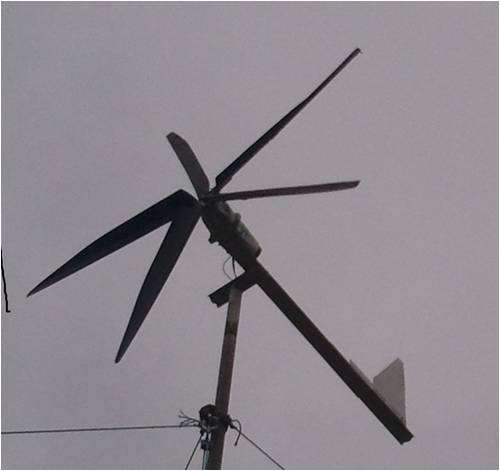

Hi im back and still in need of your help got my first mill built and it works BUT it keeps smashing the blades.
I have tried 3 different blade types (all home made ) a 6 blade a 5 blade with different lengths of blade.
All have come to a sad end 1 was due to no lode i think it went to fast.
I have a Kettler dc motor
1.8 hp
220v dc input
6 a
1300w
4800w
4800 rpm/ccw
Model GMCD105
Anyone with some advice on size of blade shape patterns amount funds are low so has to be home grown.
Please help

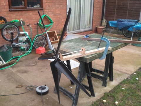

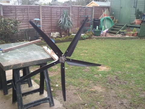

redbullalan
Joined: 17/01/2011
Posts: 38
Posted: 10:33pm 09 Feb 2011
Hi i have see two plans on wooden blades the chainsaw one and one from utube
Has anyone got some dimensions or how to plan for the blades size i need i can do a 4 blade.
useing about a 600 blade then hub 600 blade is this the best size ????
What angel see one for 22 d is this the best all comments would be much appreciated
Thanks for your tome so far
This is a pic of the ones i put up today don’t know how long they will last
Spent some time balancing them
Reddbull alan
