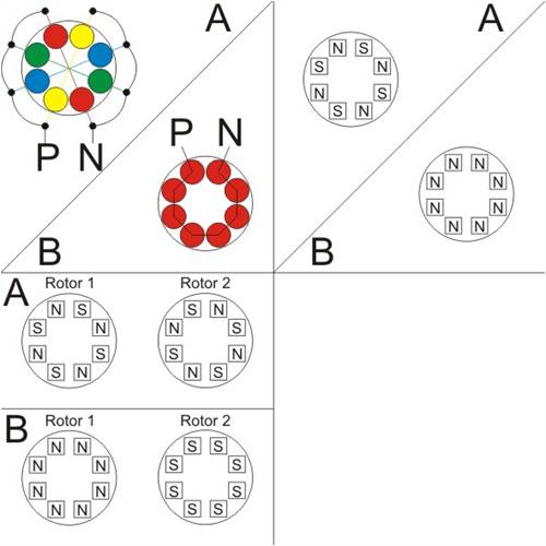

Hello All,
I've to create a single phase stator for a specific application to convert power.
I've some questions and and i'll like to ask for some help of you guys if possible.
I'll describe my doubts but those are also on the image below to help visualize the doubts.
On the first square.
The best way to wire the stator coils on a single phase mode is A)Wire 2 coils in series totalizing 4 pairs or B)Wire the 8 cores in series one after the other !?!?
The second square
The correct way to define the magnet poles for the rotors (in single phase) is A)Reversing the poles N/S or B)All poles are pointing the same direction ?!
The third square
Since the stator will be in the middle of two rotors the correct way to assemble the rotors on it are A)Reversing the poles N/S on the rotor 1 and also inversing the rotor 2 poles to stand against the rotor 1 or B)Inverse the magnet poles all N on rotor 1 all S on rotor 2 !?!?
I'll like to ask as well the correct number of magnets on each rotor for each coil !?
Really Thanks All

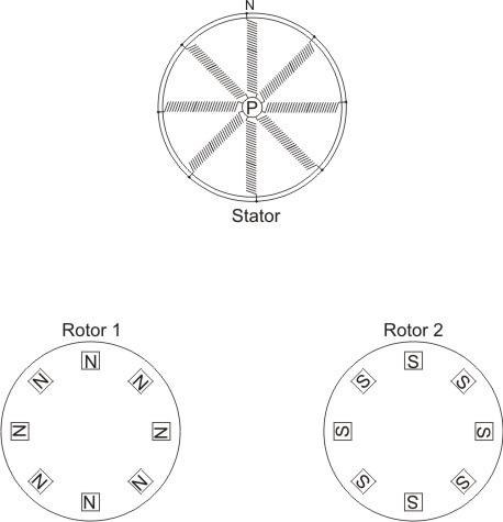

Hello Tinker/All,
As suggested i took more education on the subject and came with another design.
Please if you've any suggestion to improve it or saw anything wrong please comment.

Niall1,
I see that in order to produce power it must be like phase in/phase out, like all magnets passing on the coils and after it out the coils.
Im worried if the magnets on my plan are on the correct position, i mean one rotor is totally north and the other totally south.
The design is also illustrative, i'll find magnets that can fully cover the coils
Im missing something !?

yes ..the mags should be n/s/n/s on each rotor....the rotors will attract each other as the n/s pattern on one rotor will be directly opposite the s/n pattern on the other
if you imagine the the rotors rotating , a coil will be experiencing a pair of n/s mags passing over it and then a pair of s/n
the upper and lower parts of the coil dont really do anything as its the wire that is perpendicular (or cut) by the magnets that is causing a current to flow....

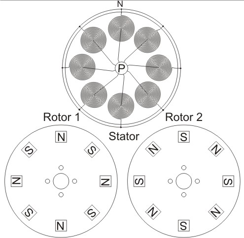

Hi,
I think that it's correct now :)
niall1

erm....Hidamen
earlier i said ...
"a coil will be experiencing a pair of n/s mags passing over it and then a pair of s/n"
in a single rotor design its easier for me to get my head around it like that ...but with dual rotors its a bad description
the magnet pole layout will still be the the same...but its better to think about it in terms of the magnetic circuit alternating through the coils....
