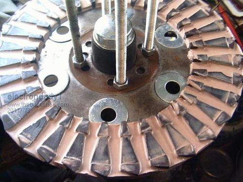

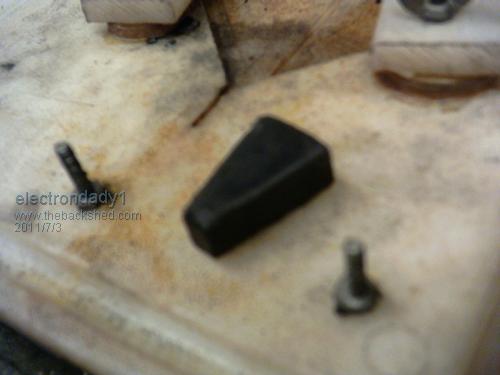

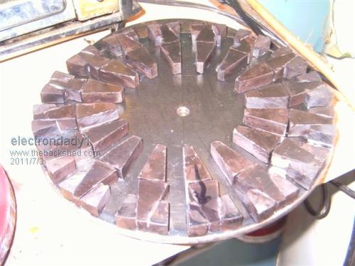

i have cut up a lot of ceramic mags on a tile saw.
starting with round speaker magnets and forming them into wedge shapes for dual rotor axial flux alternators.
it's easy to do and doesn't hurt the magnetic properties.
i would advise a bit of a rain coat and rubber gloves as the sludge that is created is very tough to get out of your skin and clothes.
the mags are very sharp after cutting.
the rubber gloves should be kind of heavy duty.
as well,the sludge behaves very much like iron filings.
and a small amount will stick to the new magnet.
a power washer or a neo mag is handy for removing it.

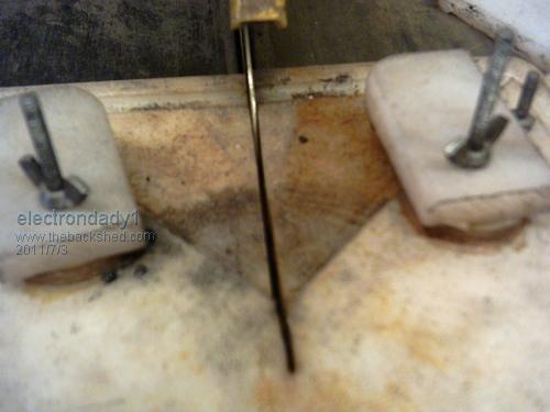

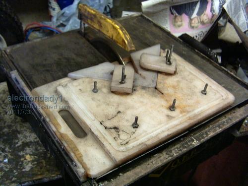

i used h.d.p.e. (kitchen cutting boards)to form a kind of mitre box jig
it separated the magnets from the table of the saw which was magnetic, and held the magnets securely to facilitate accurate angle cuts.

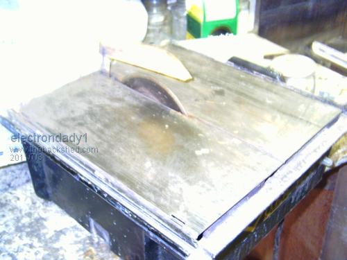

Posted: 11:47pm 02 Jul 2011
ok,
i have no Gauss meter.
but i detected no difference in magnet strength as a result of the cutting process.
the diamond blade draws water up from a reservoir beneath the cutting surface to were it is needed.
the sludge is spun back into the reservoir were it quickly settles out.
when dry the sludge is a very fine powder.
i kept as much of it as as i could for future projects.
you have to let the saw do the work and not force it too much or small chunks will be pulled off, and they do retain there magnetism .
the surface of the saw is not magnetic .
it is stainless steel but it's the kind of stainless that is attracted to magnets.
