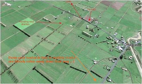

Hi Rastus,
Thanks for the welcome :)
Thought I'd tack a pic on showing you directions to the wobbly crack zone so you could take peek. Lot of peeved folks down there getting sick of the shakes which I can well understand.
Your neighbor was nice lending the saw, I just added two 110cc golden oldies (1934 and 1957) to my collection :) Its good to hear that some of those in or ex community service offices are thinking and sensible people.
Going by what others are replying here replying here re watching mills built by other forum members I climbed up on the roof of my shed just to see how high the peek was and measured 7.8 metres down. Figured I might as well go ahead and fabricate a 15 metre mast and mount that just behind shed which will be some 80 metres from the roadside and approx 250/300 metres from nearest neighbor just to see what it looks like and tack a wind measuring device on the top to get some sort of measurement and wing it from there...

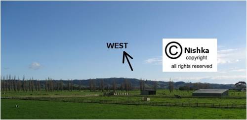

Rastus,
What no trees ??? Can't you see them all ;-) haha
How much wind disturbance do you reckon I will get from them thar forest ?
Mast placement to be left 1/4 of pic ...

Hi John,
You will definately exsperience turbulence from the staggered tree line.I'm assuming your prominent wind directions being S,W,N, so 15mt mast should get you into clean air as you've suggested.A common suggested clear air distance from obstacles is 10x the height.That distance will have variables for individual sites I suspect.
