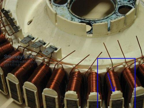

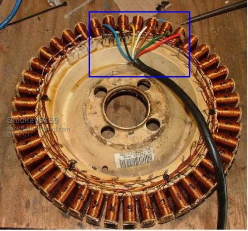

Hi,
At the risk of annoying all you good folks - could I just get a direction on the stator set-up that I have mentioned. I know there are variables of which I appreciate - I just don't want to wreck my solar power regulator, batteries etc with their 40volt, 20amp restriction. So in light of that and not taking into account the wind, rotor etc, just the stator wiring for the 7 phase cogless set-up. So in essence, which one of these...
So...
7Phase 1X6C = 6 coils wired in series. Max volts, good for 48 volts systems or 12 / 24 volts on a slow running turbine.
7Phase 2X3C = 2 lots of 3 coils. Less volts more current than above. 24v systems
7Phase 3X2C = 3 lots of 2 coils. 12v systems.
7Phase 6X1C = 6 lots of 1 coil, all wired in parallel. Max current, suits a fast windmill. 12v systems
Regards, Somkey

Smokey5159
Joined: 28/06/2011
Posts: 11
Posted: 12:22am 10 Jul 2011
Hi Mac,
I posted this info 7 posts back... "an answer if I may"
I don't think it's wise to test yet because I want to rewire the stator for a 7phase decogged motor. No sense in testing, because it is still in original form from factory. All I want to do is rewire it for a 12 volt charging system with a 40 volt, 20 amp max input - nothing more, nothing less. I can't do any test obviously until after I have rewired the stator. That's why I need to know what wiring configuration to do before I start the rewire.
So, out of the 4 - 7phase selections above (1X6C, 2X3C, 3X2C, and 6X1C) - which one is guaranteed not to fry my solar regulator (40volts max and 20amps max). that is all I want to know.
Please help!
Smokey

Posted: 03:40am 10 Jul 2011
Hi Smokey
No garentee's when it comes to wind. Without a furling system, in storm conditions, a 100 windmill could make double the power before flying apart. Many of the members here have had failures due to extreme conditions, its just the nature of the beast.
There is no answer for so many unknown variables. Try a 1X6C, most likely to work in low winds and not burn out your controller, a good starting point. Later once you get to know the machine, you could try converting it to 2X3C, a fairly straight forward mod.
Hope that helps, let us know how it goes.
Smokey5159
Joined: 28/06/2011
Posts: 11
Posted: 04:42am 10 Jul 2011
Guys!!!
Thanks heaps for getting back to me.
Mac, appreciate your frankness - cheers Bro.
Glenn, sounds like a good start - thanks for taking the time respond to me, a vague persistant wannabe.
Mate, I am pretty mechanically minded, and understand a lot of what I have read in the project section. Is it ok with you though if I get stuck to quiz you now and then? Like my first question - where do these wires attach that disappear in-between the stators?
And where it says... "I found if I unwind the outer coil one turn, it was then long enough to reach the next coil, 7 poles further around the stator".
Does that mean fully unwinding a whole stator pole's length of wire, or just one turn?
