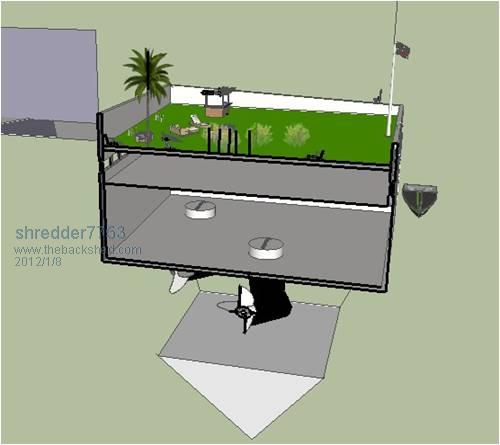

After my test platform is complete i hope to install these 2 generator units to the bottom of a floating concrete island which has many small electrical components to run:
http://seasteading.org/interact/forums/community/active-seas teading-projects/berg-3rd?page=5#comment-19380

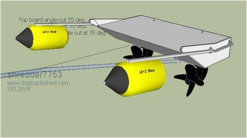

so this is what my test platform for the generators will be like:
heres a cut-thru image of my floating private island design. its called a "Bergstead". I want to make it possible for people to live autonomously outside of any existing nations legal territory.

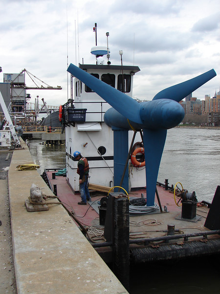

What you are building is called a free flow or kinetic reaction turbine. my guess is without a pipe wall to hold the water in and guide vanes to create a vortex, a lot of the kinetic energy will slip around the outer edge of a small prop and be lost.
There is a lot that can be learned from larger commercial systems. this is a good example from the St Lawrence or East river NY, the prop speed here is 32 RPM but the gain is the water will flow smoothly over the blades with minimal cavitation and stalling creating huge amounts of torque.
image:verdant power inc
I wouldn't be to worried about wiring a generator for the peak flow in a semi tidal river the top end normally takes care of itself, as there is an exponential increase in energy available for every unit increase in speed. the points that are more important are the revs (and load) that the generator climbs above the battery voltage and starts to charge (called cut in volts)and the revs that most of the charging is happening.
I think a large dingy with a nice solid transom and a little outboard motor would make a good test bed.
Home made dynometers are not that hard to make, with a few bits of junk, a spring-gauge torque wrench and a handheld rev counter!
