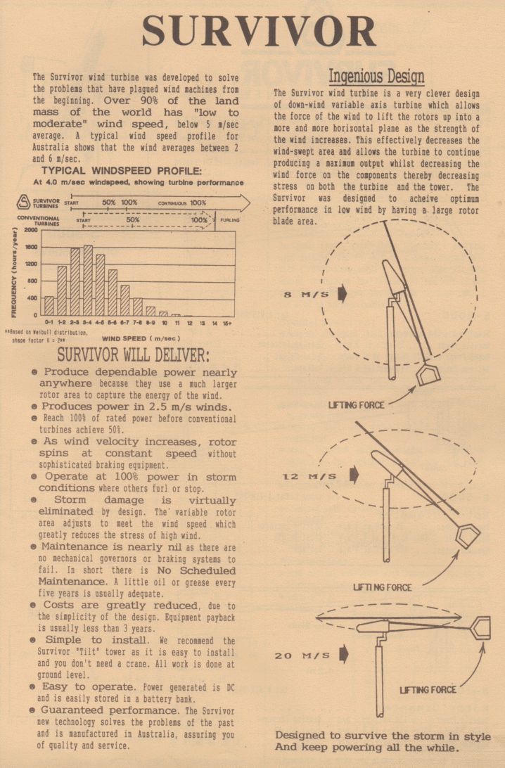

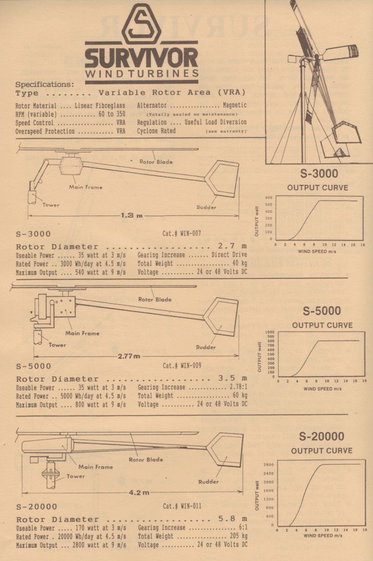

Recently I've been reading a 20 year old book called Energy from Nature, 7th edition, by Peter Pedals of Rainbow Power Company. The book is about setting up a off grid system, and includes solar, wind, hydro calculations, cable sizes, etc. Good reading, and I see they still sell it, but its now up to the 15th edition.
http://www.rpc.com.au/catalog/energy-from-nature-living-with -solar-p-981.html
There are a couple of pages about the Survivor brand of wind turbine, and I though it had a interesting furling system. I think they are now called Synergy.
Below are a couple of pages from the book. Normally I would say you shouldn't post material from a book or magazine as it infringes on copyright, but this was more of an advertisement in the book, and I think both Rainbow Power Company and Synergy benefit from this post.
Anyway, I think the furling system is clever and simple.

Cool idea on how they furl ,simple ,really ,more wind less wind facing surface area from the blades. They drive a car alternator vis a "v" belt pulley system .

I think the furling system used by the Survivor has merit. It may be more suited to the high torque GOE222 blades that struggle with the offset tail furling we often use. I think as a DIY builder its worth experimenting with.

My experience with this type of furling is that the gyroscopic forces cause the mill to rotate around the tower axis every time it furls.You can see this effect by spinning up a bicycle wheel by hand and then try tipping it up.Very hard to control although the lower tail assembly may help counteract this somewhat.

I first saw it here usa solar wind it is shown as a 30 Kw generator, I notice the website has not changed since I last looked at it 12 months ago.

Here's a Hot Link that shows the mill tilting.
This is much the same as I did in Florida back in the day. I used one of my little towers with a counter weight at the base of the tower, which held everything upright until the wind started jamming, at which point the whole thing tilted back.
My wind came from the west constantly, so I didn't have to worry about heavy winds coming from the side. My tower application works in a similar manner, but only where there is consistent wind from the same direction all the time.
I kinda like the approach taken in the video link above, because all the guts are in one place hanging alongside the tower. The only really tricky part would be the gymbal at the top and getting the wires down the main tower without a twisted mess.

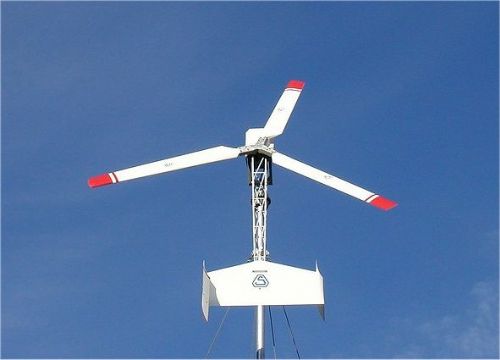

It looks pretty cool and makes good sense for a furling system but as I think about it there are some drawbacks to the design. When you think about blade loads and fatigue the torque forces would be a nightmare. Torque forces during yawing are pretty large. This machine has torque forces from yawing plus torque forces from furling at a right angle. I would bet that you would brake some blade roots or hubs after a while. Plus, aerodynamically, you usually have a tower shadow that messes with loads and efficiency, this machine has a shadow from the tower and the rear fin support. This is just my opinion of the design not knowing much about it. It my be an awesome machine.
Perry
**edit**
I googled it and found Hugh's page. There is a short discussion on it about half way down. With a pretty interesting picture.
http://www.scoraigwind.com/Scoraig/index.htm
