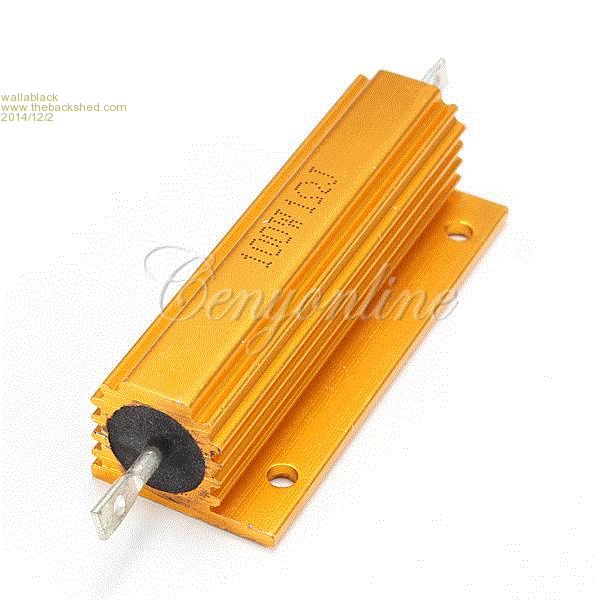

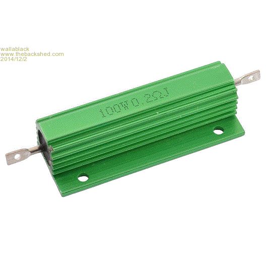

Just working on a couple of little "refurbishments" of a couple of old turbines, one is 12V one is 24V.
Found a couple of cheap aluminium clad wire wound like these.
100W 1R for approx. $2.50.
Am I correct in saying that I need 5 of these for the 500W 24V?
29V/1R = 29A
500W/29V = 17.2A
17.2/29 = 0.59 (1 Resistor)or x5 to gain 500W
100W 0.2R
Am I correct in saying that I need 5 of these for the 500W 12V?
14.4/0.2 = 72A
500/14.4 = 34A
34/72 = 0.47 (1 resistor) or x5 to gain 500W.
I think I am confusing myself because something does not seem right...
Foolproof systems do not take into account the ingenuity of fools.

Hi Wallablack,
The simplest way to avoid confusing yourself is to do the calculations in a logical sequence.
If you want to be able to dissipate 500 Watts at 29 Volts (using 29V as you have, rather than 24V), then the current involved will be 500/29, or 17.2A, as you have calculated.
To pass 17.2 A with 29 V applied, you need a resistor of 29/17.2 = 1.68 Ohms (pure Ohms law - R = E/I).
With 1 Ohm resistors available, you can connect two in series to give 2 Ohms. If, though, you connect two series pairs in parallel, then you get back to only 1 Ohm total, although now with 400 W (max) capability.
If you connected 3 one Ohm resistors in series, then the total resistance would be 3 Ohms, and two of these sets of three 1 Ohm resistor strings connected in parallel would have a total resistance of 1.5 Ohms, and a nominal dissipation capacity of 600 Watts.
Using the same process on the 12V application, the required resistance value for 34 A at 14.4 Volts (ie 500 Watts) is 14.4/34, or 0.42 Ohms. If you use the proposed 0.2 Ohm resistors, then you would probably need two parallel strings of 4 resistors in series. Each string would have a resistance of 0.8 Ohms and, in parallel, the total resistance would be 0.4 Ohms. As this would take a total of 8 resistors, the maximum theoretical dissipation would be 800 Watts, which would be more than ample.
Obviously, you can play with other available resistance values to reduce the number of resistors if you wish, but it is far better to have more dissipation capability than less. Note also that, if you mix resistance values in a string, be careful to check the dissipation of each resistance to ensure that one is not overloaded.
I hope that this helps.
Don B
Posted: 11:47pm 01 Dec 2014
And don't forget that these resistors need to be bolted to a substantial heatsink to be able to dissipate their rated power. Also, use heat sink goo under each.

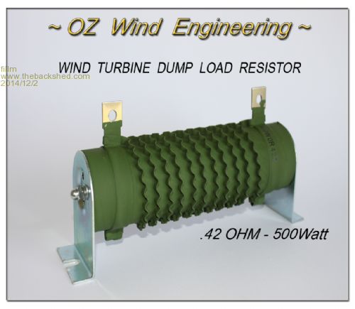

If you want a 500W / .42Ohm that are the built for Wind Turbine diversion loads, I do have them.
If you do not want to do that way then I think you would be better of making your own -- winding wire around a tile/ fluro tube Encapulated Resistors and many other ways rather than using Audio Resistors.
