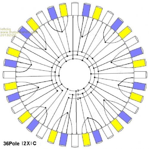

leftcliq
Joined: 21/07/2012
Posts: 51
Posted: 10:30pm 25 Feb 2013
Hi Guys,
Here is what I think the 12x1c should be wired up. Can someone please let me know if they think its correct?
Dale.
daveames
Joined: 19/09/2009
Posts: 30
Posted: 07:51pm 26 Feb 2013
Hi Dale,
Nice job on the sketch.
Afraid I'm still not sure what you're up to with these stray bits of equipment?
Couple things stand out from here.
Your numbers show an open voltage* of about 12v to 18v at 200 to 300 rpm using 12x1c.
If the plan includes trying to run the rectified dc into a standard dc-ac inverter, Then time for a new plan.
Really need to go..Alternator->Rectifier->Battery->Inverter->Lo ad. Then some kind of charge control in parallel with the battery.
Great Fun!
Cheers, dave
*Open voltage, ..we need to get at least up to and past this voltage to begin any kind of charging in a battery system.

leftcliq
Joined: 21/07/2012
Posts: 51
Posted: 02:37pm 27 Feb 2013
Hi Dave,
I know the diagram is a bit rough and was done in haste but I think the connections are correct.
From my sums and testing of other wiring setups (and your reply above), 12x1C should generate an open voltage of 33 Volts at 6 Amps at 200 RPM. Am I wrong in this? I thought this will be enough open voltage to be useable? The design is there to charge a battery and the load is ran from the battery.
I was going to seperate each coil and use terminal blocks so I could rewire the smart drive motor as needed in any case.
I'll check the resistance of the coils. Yes I checked out the windstuffnow pages. There info was based on the 42 coil smart drive. I will re-read it in case I missed something.
