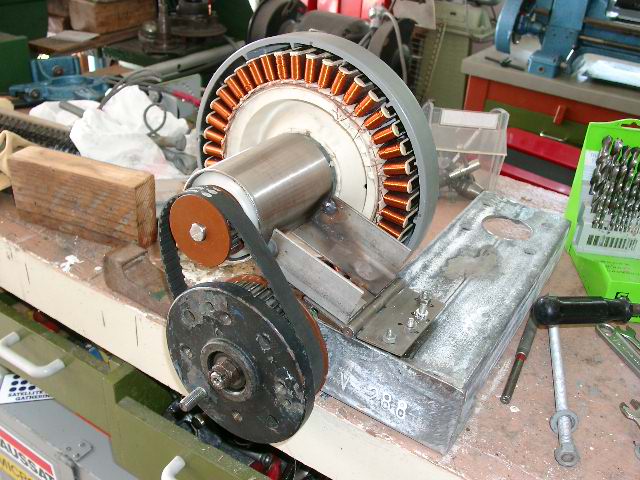

This is the way I mounted the cut out section of nylon bearing housing from the F&P bowl.. Sabre saw it out first ,roughly. Then with a sharp spokeshave ,trim the edges to make a firm fit inside a "carrier(this one is stainless steel tube ) .. Pop rivet it in a couple places and move on from there.
Have fun,,Bruce

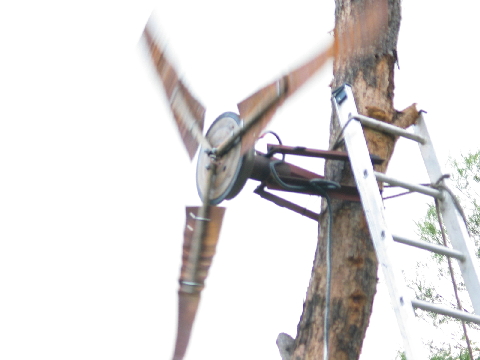

Bruce the pic is good. I have one for you on the other end of the spectrum, this is my rough as guts version. It is fixed to a tree facing south. The blades are from a shell 44 gallon drum, but they are not stiff enough. I wanted something up in a couple of hours, and it is still working fine, though I dont think it will last forever.
cheers Robert

Hey Robert,, very Innovative,,reminds me of the machines out of "mad Max".
I actually whacked up a set of similar sheet steel blades at work years ago. cut them with a jigsaw and rounded off the leading edge across a wood pallet outside my workshop at work. Had an audience within 1/2 an hour ..Man, you should have heard all the white shirts and suit's advice ,,,made me go slow on the noisy jigsaw,lol..
Remember ,you guy's , Trevor makes a very nice Aluminium cast hub that slides onto the f&P spline ..makes your project a lot easier ,as the hub 's 3 blade holders are cast at the correct angle --all you have to do is bolt on your blades and balance.

Bruce - what reason for using a belt drive? Can understand it may lessen the vibration and provide adjustment, but doesn't it add complications in mounting and add to maintenance. I saw somewhere on this forum that an early Corolla tailshaft fits the FP spline and would be more inclined to use that with a mounting plate for the blades - comments appreciated

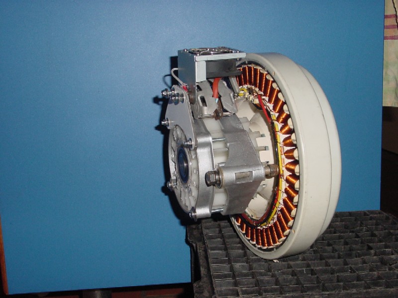

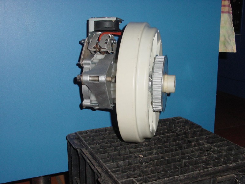

here are two pics of my version:
F&P between car alternator halfs,
and timing pulley with slots fixed with silcon into rotor.
Harald

Gee Harald,,that looks nice.
I see you have a small computer fan at the top ,,possibly above the bridge rectifier??.
Your use of the alternator rectifier and case is very good ,,you now have the alternators mounting flanges to use.
Could you post a few more pic's of the way you attached the shaft to the rotor ,,,and,, how hard is it to remove the rotor from the stator (I'm thinking of the magnetic attraction) ??.
Like that ,,very neat..
Bruce

Hi Bruce,
original F&P shaft with spline.
Original F&P plastic nut to remove/adjust the rotor.
more pics later.
Harald
