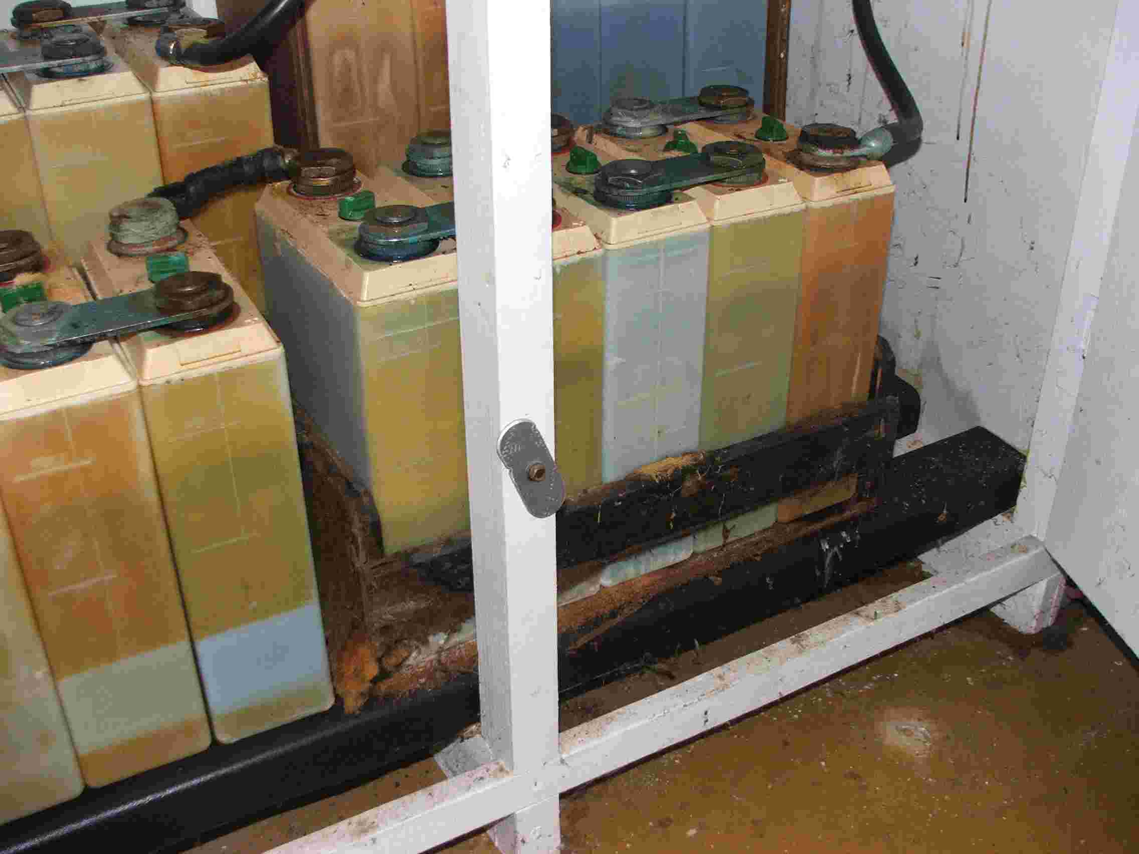

Phill, my opinion on these for what it's worth is while they are useful, enquire about disposal before acepting ownership.
My experience in comercial use is the case frets(cracks) well before the battery expires, concider what you or your children are taking on.

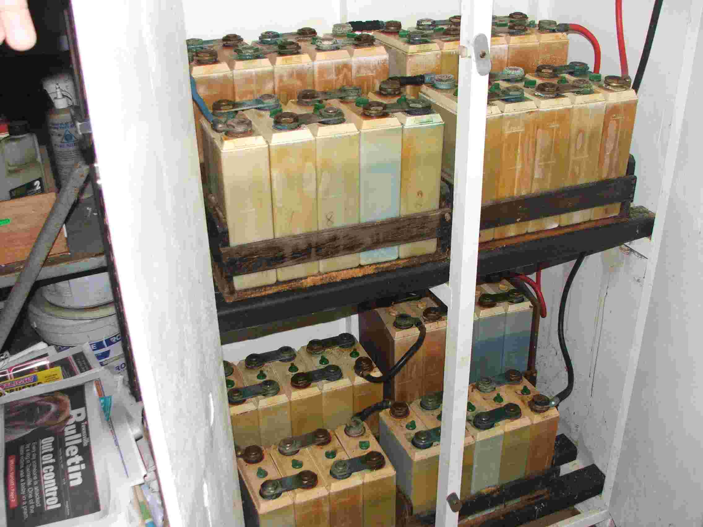

Prof
Joined: 01/12/2005
Posts: 33
Posted: 10:56am 15 May 2007
Hi Phill,
As these batteries age, they do develop cracks and leak. It eventually becomes a nuisance and they will need to be scrapped. It is possible to fix up some at the beginning of the failures by using hot melt glue, but eventually repairing becomes unviable.
See pics of the bank I have now decommisioned.
Prof
I know boats!!
