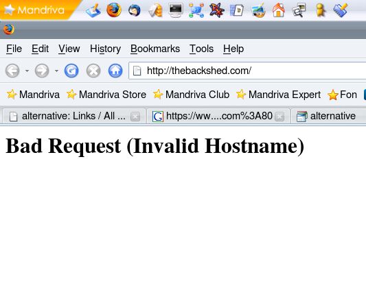

Just by accident typed in the URL without www.
http://thebackshed.com/windmill/forum1/default.asp
And got back this!
Bad Request (Invalid Hostname)
Whatever it is, Glenn, contrary to Gavins claims that everything is "perfectly valid", it is *NOT* working properly. I'm not planning any further diagnostics lest I step on any toes, nor am I going to say what is (or isn't) right, wrong or anything else save "it's broken" as other members have already reported.

Also from my Firefox under linux ...

  RossW said   Just by accident typed in the URL without www.
And got back this!
Hey Guys,
Ok, I've found the cause. It wasn't DNS it was the webserver itself. I have fixed it on Glenn's behalf as I dont like to fiddle with what's not mine. Glenn, I will contact you and show what I did to fix it, it may come in handy next time you setup IIS.
Gavin...

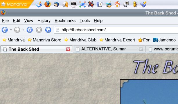

Is done! The new host is now "home, sweet home".

Thanks Gav.
The penny dropped when Ross showed the web page he got with "Bad Request". I bet it was something to do the the "host header name" in the IIS. It understands where to point www.thebackshed.com but not thebackshed.com
First time I've used host headers to set up more than one site on a single ip.
