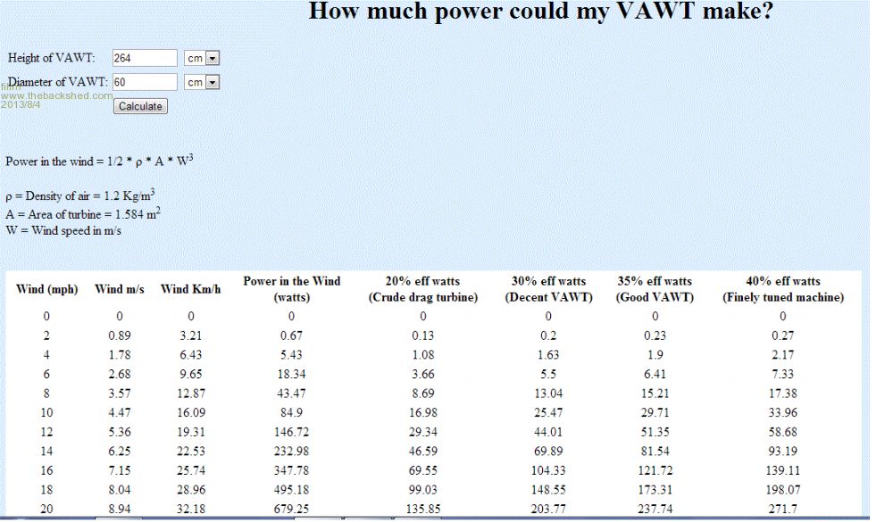

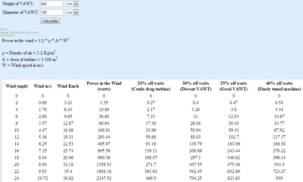

I think a few quick calculations might put your problems into a different light.
You say you have 3 x 200lt / 44gal drums cut in half and mounted on top of each other, I am not sure if you have a overlap but I will take it that you don't and it gives more swept area . A 200l measures 880mm H x 610mm , that then would give you a swept area of 2640mm x 600mm which comes to 1.6sq/m, this is all worked out using the calculator on USVAWT HERE .
This shows what power is actually available in the wind VS a 20% crude VAWT .
So with turbine power, less bearing seal loss , less cogging loss I think starts to say that gearing or trying to load the turbine any more is the wrong way to go .
Rather than going with increasing the size of the swept area until it can drive 1 F&P you can look at reducing the load as the 60S cuts in by using Caps in the reverse way to the doubler and that is to use caps to AC couple to the Rectifier and by adjusting the capacitance will determine the loading.
Posted: 04:33pm 03 Aug 2013
You need to double the radius. My 44 measures 590mm diameter, so cut up and built into a savonius with no overlap, you get a diameter of about 1180mm.
A savonius would be regarded as a decent vawt, especially if its got overlap or a modified savonius. A crude VAWT is like a wind anemometer or something made from wheel burrows.
But still, only good for about 50 watts shaft power.

Yea,OK, I Realized I did Radius but in reality it doesn't make much of a difference, I would think of a 44/200L cut in half as a large anemometer and fairly crude, and more the Lenz as getting more to the decent.
Anyway more so I was trying to highlight that advice is to easily given, and to have an idea on what power is available to work with first , but also know that having good information to start with helps.
Having a overloaded/stalled mill means NO POWER is produced in that state. If Anything it would better to run slightly under-loaded with a mill like this that is virtually self governed, so that would mean sizing the power input to suit the chosen alternator or building the alt to suit, but as I have said previously there are other methods but it just takes getting the grey matter around.
Here's the updated power output table from USVAWT which I still think is leaning to the Generous Side
