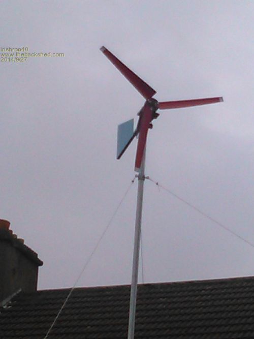

Hello.I made a wind turbine fromvtreadmill motor and pvc blades. Its on a mast and mast is bolted on house wall and also secured with steel lines.the pole start shaking in line with the turbine once reaches about 300 rpm and above.why could this be please

Sounds like a out of balance turbine. Did you balance the turbine, its pretty important to get it right.

I have all 3 blades 120 degree apart and all 3 blades are same size and weight

Ok. Done some searching Glenn on balancing. Levelled motor and checked for heaviest point point. I was suppriced what weight differents was in it. I also removed brushes while balancing. Am checking her out after , and let ye know. The soo much for putting me in right direction
