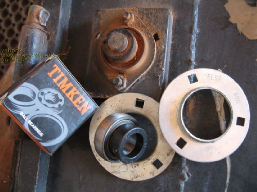

for a test bench application, if you have the washing machine you could chop the original out of the drum and clamp it with an u-clamp I guess.
this is a pretty standard bearing mount style, I call them a flange mount off the top of my head it is something like pf205 for a 6205 bearing. is it a different size bearing on the other end of the shaft? i think it has a flat outer surface 6005? 25mm shaft?
more info
PS bearings from the company FAG are not known for their long life.
