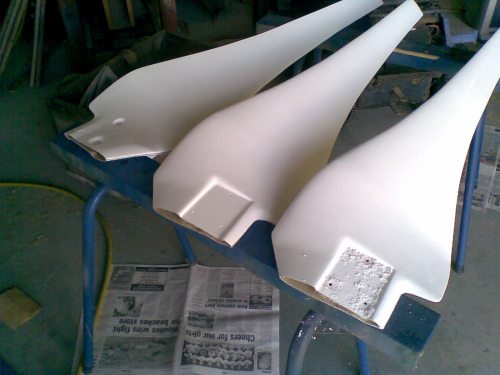

Trev dropped off a set of the new fibreglass blades on his way out of town on holiday. The blades were not finished, he didn't have the time to glue on the end cover plate or sand back the glue along the leading and trailing edges.
So this weekend I sanded back the edges, drilled the 3 1/4 holes and covered the ends with tape as a temporary fix, we dont want the blades filling up with water! The blades are hollow, and weigh just over 1 kg each!

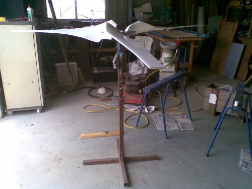

Next I mounted the baldes onto one of Trevs cast hubs. The blades are designed to fit over the hubs 3 mounting brackets.

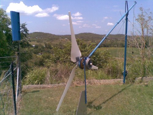

Then out to the tower. This is my dual stator staggered connection windmill, it normally runs the 6 blade PVC turbine.
And up in the air.
I wanted to keep a large surface area around the root end of the bades to aid startup, and that has worked wonderfully. The dual stator is not decoged, but these blades had no problem starting the windmill in light winds.
However...
The blades could not make enough power to get over the staggered stators first cut in stage, about 40 RPM. If I open circuit the mill, the blades very quickly speed up, and then if I re-applied the load it would quickly slow down. But this makes sense, the dual stator windmill was built to run at low speed with a big grunty 6 blade windmill. The new fibreglass blades are designed to run at high speed.

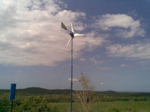

So I took the mill down again and swapped the dual stator for a 7 phase 2 pole mill, single stator mill. Back up in the air and straight away she got up to cut in speed, in the lightest of winds.
The winds have been light all afternoon, but still the windmill is a blur with no load. There is some noise, but I would consider it to be quiet. Under load the windmill has been making a couple of amps, comparable to the dual stator 6 blade mill in these sort of winds. The true test will be tomorrow about lunch time when the winds pick up. Cant wait.

Well I finaly had some good wind this afternoon while I was around to watch the amp meter. There have been several storm fronts pass over during the day, nothing to strong, just enough to give the trees a good shake up.
The windmill was coping a bit of a hideing, furling occasionally. The fibreglass blades are just a blur, I wish I knew the RPM. Amp meter peaked several times at 23 amps, battery voltage was up to 15, so thats 345 watts. The windmill starts to furl at 20 amps with these blades. Its a 7 phase 2 pole, 0.8mm wire.
I'm running 7 core trailer wire down the mast to the bridge rectifier, and then 2 core wire to the shed. The 7 core is only 1.5mm dia copper, and the 2 core is only about 3mm diameter copper, so my line losses at 23 amps would be massive.
So I'm happy with those blades. They do run bloody fast in strong winds, but I couldn't hear them over the wind. The 7 phase conversion stood up well too.
